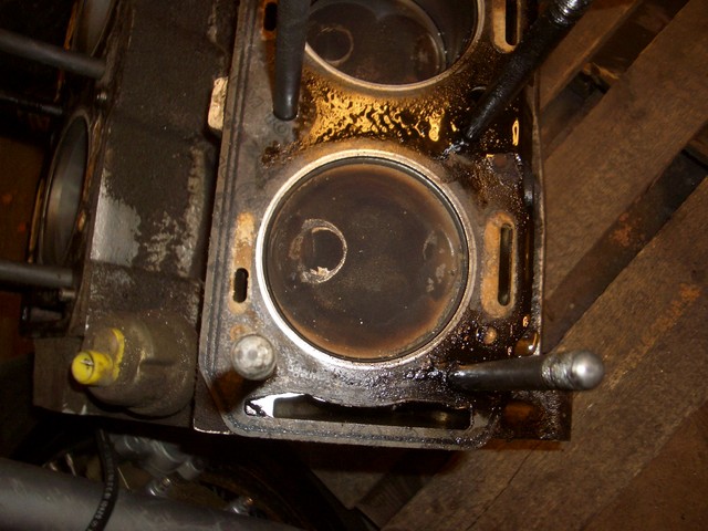

My engine projekt has damages to all pistons from the intake valves so i will probably swap them for new ones anyway. I saw the prices for your "do-it-yourself" kit, how much extra is we talkning about with the m90 unit instead?
Keep up the good work!
- Pic of damaged piston
- 2005_01_21_007.sized.jpg (83.12 KiB) Viewed 19476 times
