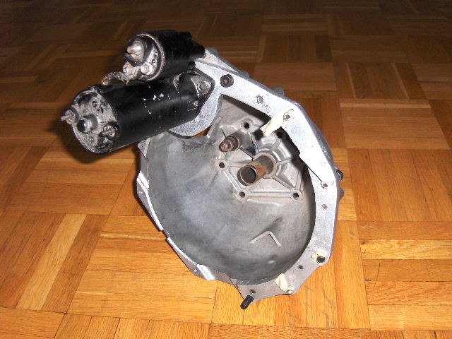

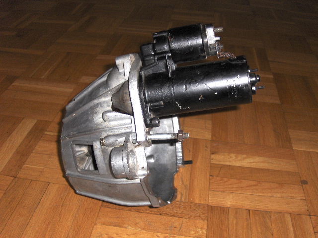

Mods to mount tranny??? Simple plate adapter with starter attached. Correct spacing and you're there. I'm working with the "automatic rear end" spider so it should give me a higher top end.

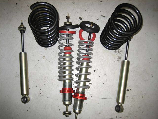

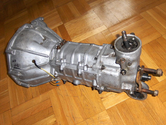

Hey guys!

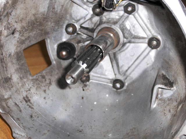

Check out what Santa has put in his sack for me and is now on route!! RSRacing's Fully adjustable shocks with springs. I also requested Ron's 30mm front sway bar to be sent along (not pictured, but coming as well)!! :D
Tranny is all buttoned up and ready - revamped with all new internals including shafts, bearings, syncros, sleeves ect. Plus close-ratio gears that have all been forged, lightened and shot peened! Tranny has a stock bellhousing presently mounted which will be replaced with the modified bellhousing - seen attached with starter on the adapter plate.
Engine has now been crated and awaiting departure from South Africa after completing testing, maping and run-in with zero problems! :D
More updates soon...
streetfame
demon's suspension.jpg (67.28 KiB) Viewed 13337 times

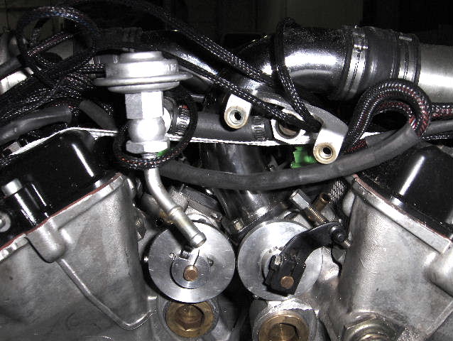

Posts: 40
Joined: Wed Feb 08, 2006 2:19 pm

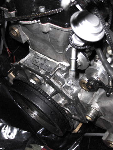

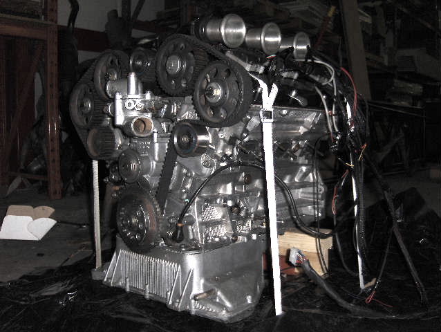

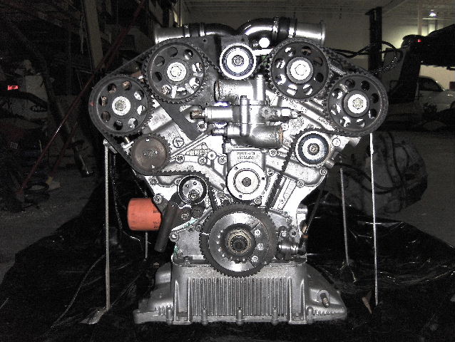

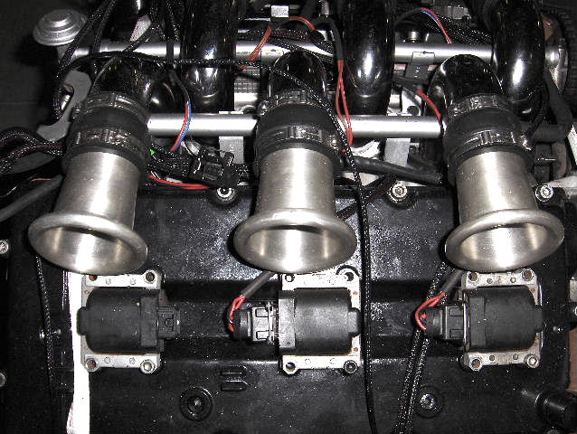

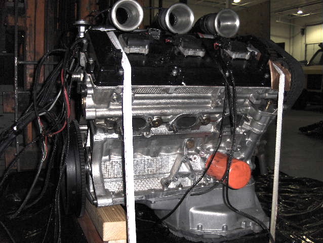

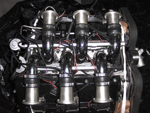

GOT IT!!!
Post by streetfame »
I'll let the pics do the talkin' :) :D :o :shock:
streetfame

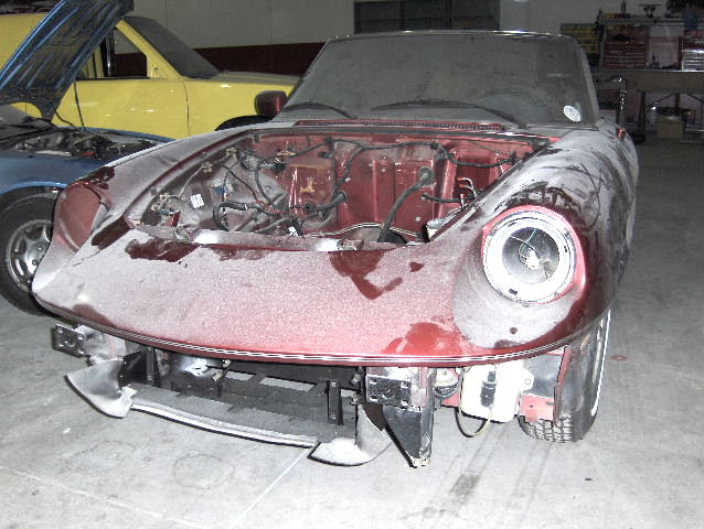

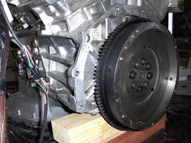

More Mayhem!!!
Dawie doing his thang for me and my spider awaiting the install!!! :P :D :D
