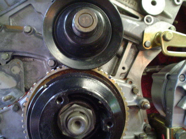

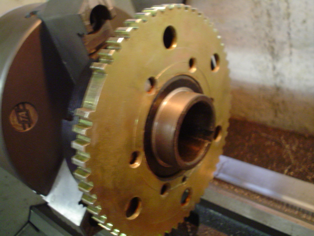

I actually had to do a 60-2 wheel on Fernando`s engine today.
Std 2.5 front pulley and 164 Motronic reluctor wheel.

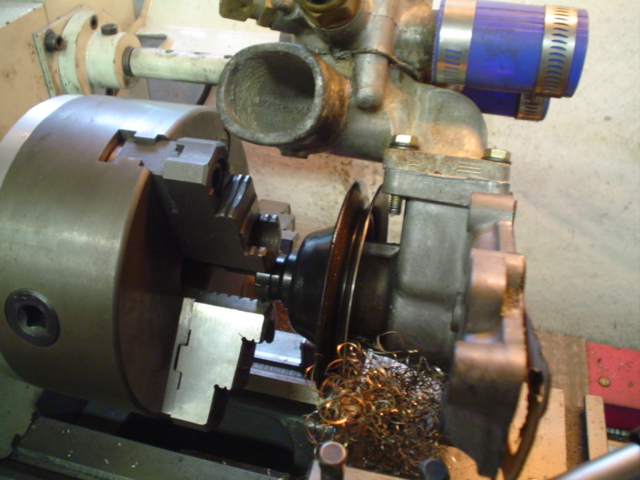

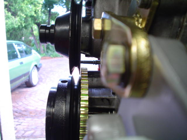

To fit the motronic wheel the waterpump needs modifying to clear..
Carefull kids..NOT the brightest way to do this...
Now we dont need to re invent the wheel (pulley) on the water pump.

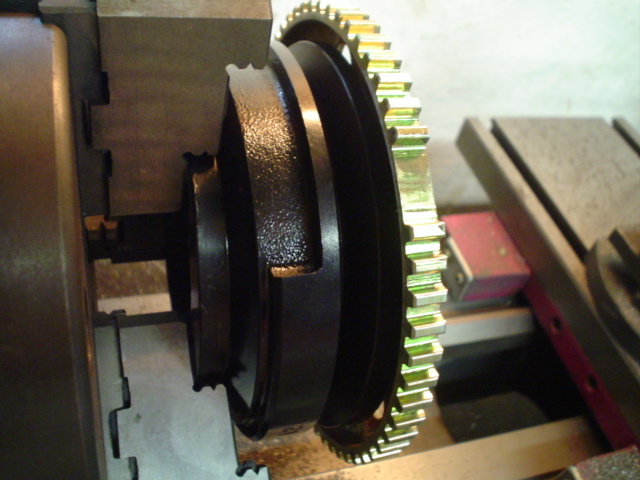

Some folks here machine the ring gear down. The water pump pulley looks pretty thin on one side. I wonder if the process of getting the belt on will break the edges of the thinned out pulley?
Zamani wrote:Barry,
Zman,not as long as I have a hole in my butt..!
This is plenty strong,even if it was cast iron.. :)
By ring gear I presume you talking the motronic wheel?The problem with that is that if they start getting to thin(I took 4mm of the water pump pulley)you start loosing signal at high revs..
