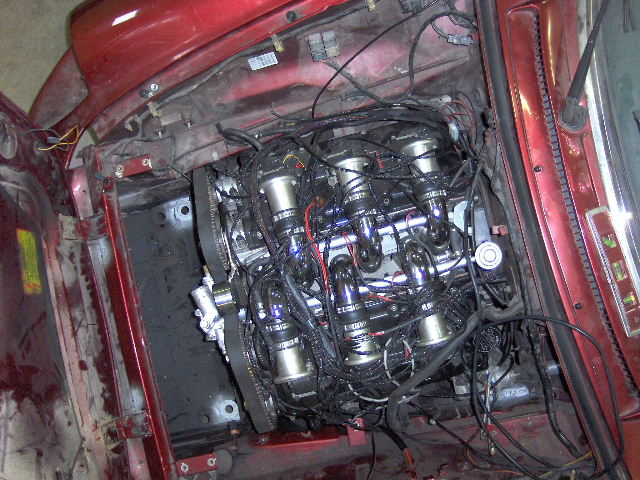

That flywheel, is it just zero balanced? The V6 stuff I have seen have had an obvious weight offset. :?

Mats, they do have obvious balance weight but it is on the engine side of the flywheel not the "clutch" side :wink:
What clutch? :wink:
That would be an explanation.

The clutch from the 105 Spider that will be right there... :wink:
The flywheel does have balancing drill-holes - they are just not very visible in these pictures. The entire assembly - flywheel, crank-pulley, crank, rods, pistons, rings, wrist-pins (even the little wrist-pin-retainers) - were balanced as a unit.

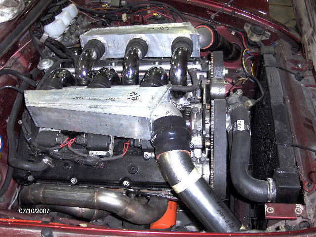

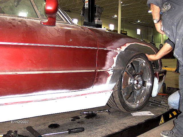

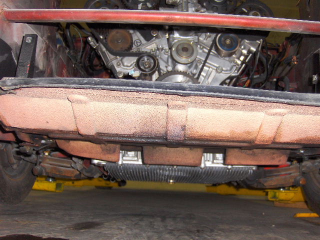

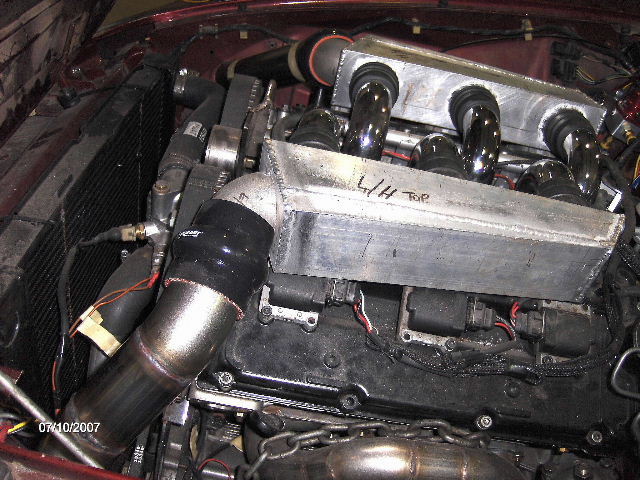

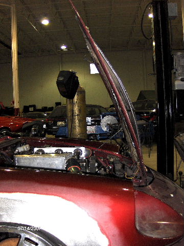

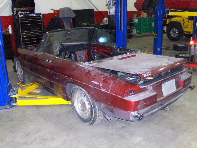

Getting it all sorted... :twisted: This being a street car, I had to keep the pan off the ground. In turn, the hood will be modified with a left to right/ top to bottom gradual taper to clear tensioner bracket and first 4 runners/trumpets. About 1.5 inch lift above normal hood placement...

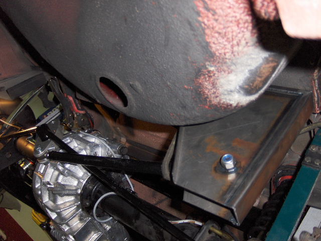

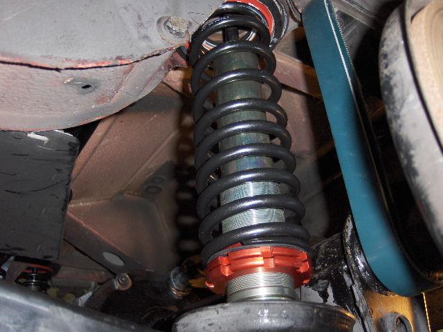

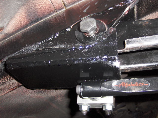

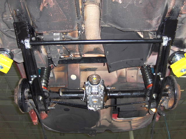

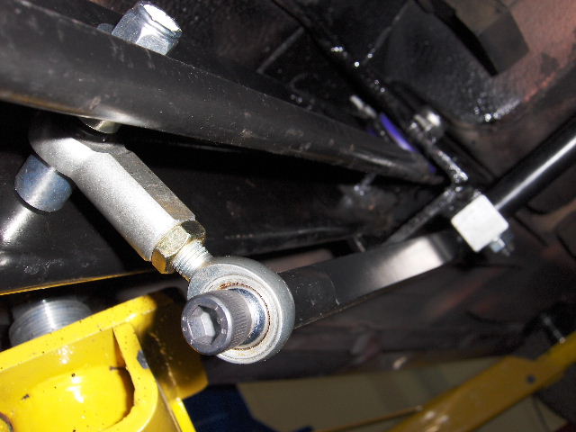

Here are a few pics of the rear end gettin' mocked/linked up...

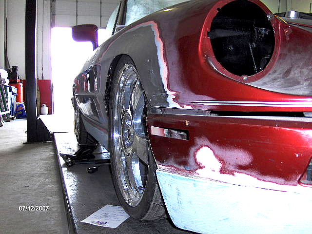

Thought I'd update the thread to show that work has not ceased. Engine work is just about wrapped up, bumper/side skirt mods, suspension stance set, interior, and sound.

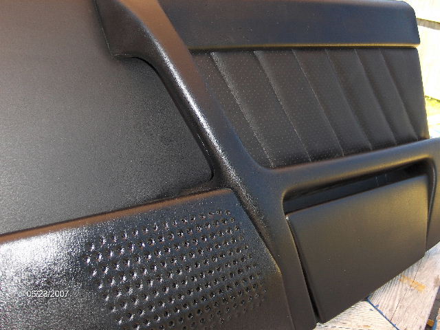

More work...
