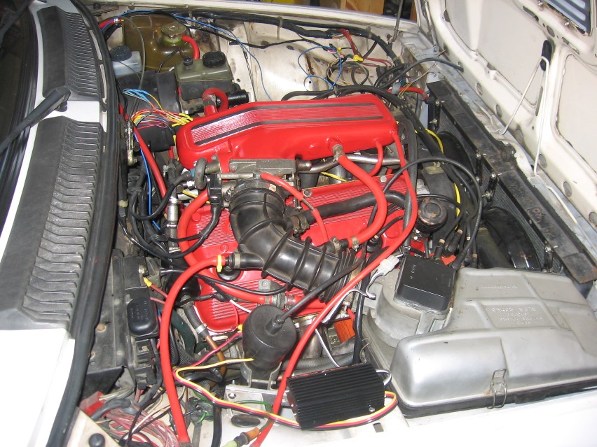

no turbo here...yet....
this 3.0 is coming out for a mild-moderate modified 3.0....

You like hot red !!

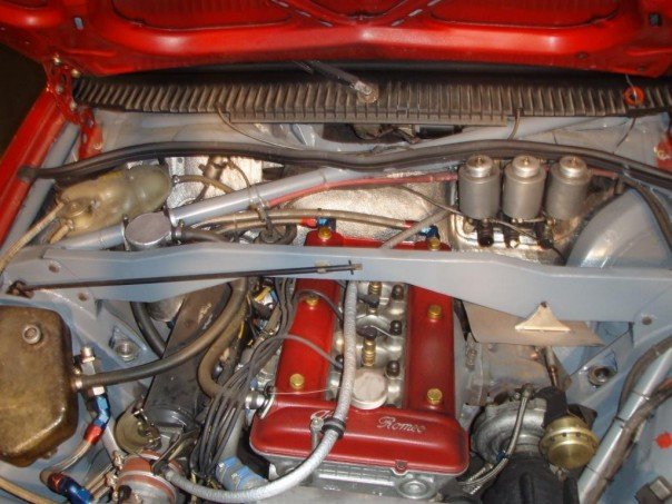

Sorry I think you have turbo engine.. I'm looking for all web pic of 1.8 turbo engine.. please help :oops:

how about this one :lol:
Rice SAE
RicoGTV wrote:You like hot red !!
regards,
eric
Exactly what do you want a picture of? I have a ton of pics on my former 75t engine but I won't post them all. 8)

This is not ok... :(
I am also curious to see those pictures! :wink:
If you wanna see a real serious turbo set up, check out the photos of Paul K's Alfetta GT 1.8T I posted not long ago, in the performance forum too.
Yes, it goes Turbo, I/C, BOV, T/B. The only thing I dont like about his set up is that they cut the front guard out for the airfilter.
With the factory 1.8T setup there prob wont be too much room for a BOV. My mechanic finished a great job on a 1.8T Alfetta sedan not long back ( http://www.alfaclubnsw.org.au/photos/20 ... 0_2092.JPG ), and they went to the extent of hooking up a cold air feed from the front bumper to under the intercooer, and putting vents in the bonnet. Made a huge difference
