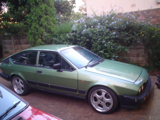

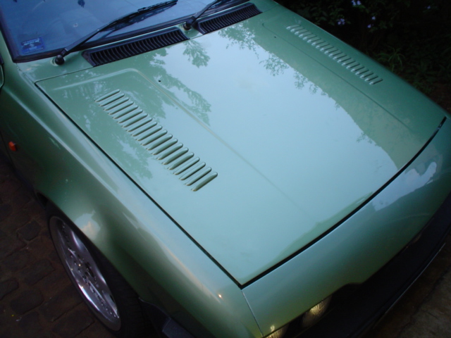

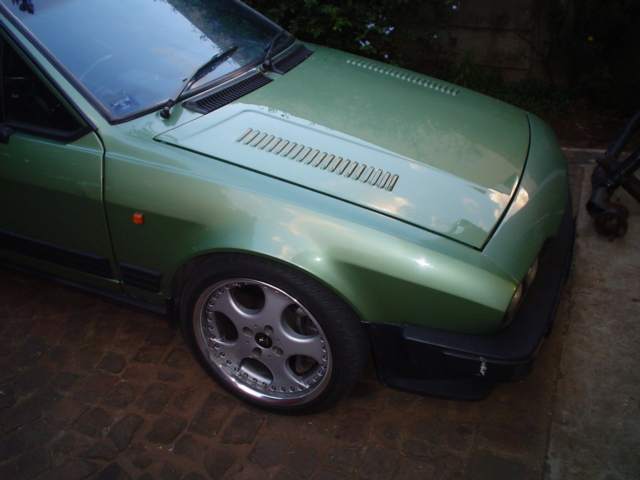

10 days later I finally get the bonnet/hood back from the painters! 10 frkkin days !
*deep sigh* Well,stuck it on and I just love louvres !
Dwayne wanted a straight through exhaust system....damn,it was loud !
Dwayne -0,Barry-1
Two silencers fitted -it sounds good.
Garth,video time now...

- DSC00476.JPG (141.7 KiB) Viewed 9165 times
and the best part of this all ?? Theres a v6 turbo under that 20l bonnet ! I just enjoy sleepers.....
- DSC00496.JPG (147.41 KiB) Viewed 9164 times
