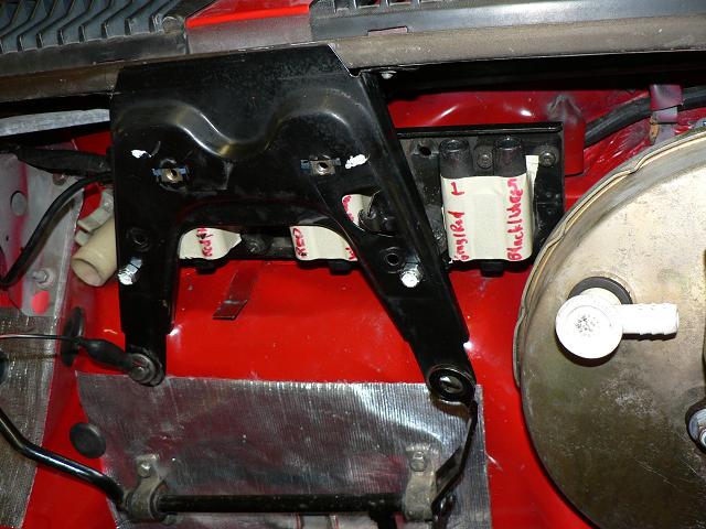

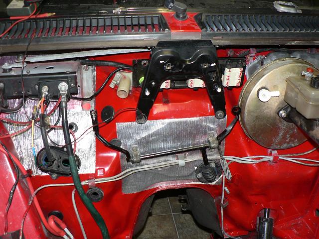

Coil packs are mounted behind the bonnet catch assembly - allowing enough room for the windscreen wiper assembly. Its actually mounted using the bonnet catch bracket with rubber vibration dampers. Anyone know if this part should be grounded to chassis though?
Mounting the coil packs here will keep the plug wiring shorter/neater and allow me to reuse my Magnecore wires (which are awesome).

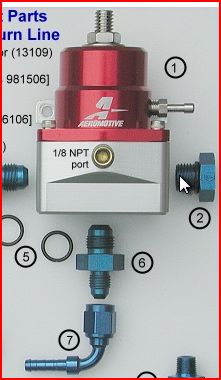

I'm installing this Aeromotive A1000-6 Fuel Pressure regulator - see drawing below.
All is hooked up except #7 - that is the fuel return line. I need to plumb a hose between fitting #7 (which is ~6mm) and the standard Alfa fuel pipe which is ~8mm.
I'm using Earl's Super Stock Hose 250 psi (overkill on the return line...) but good quality, AN Size -04 which is 1/4" ID ~6.3 mm .
I'm finding it impossible to stretch this hose over the 8mm Alfa fuel return pipe because the hose is really rigid. I have tried heating it etc and it seems impossible to fit. What I really need is to use a 5/16 hose (7.9mm), with a matching hose end (#6) but I can find only AN sizes. AN fittings do not accomodate 5/16". Also, I can find no high quality 5/16" hose (Earl's or similar).
I know Jess used these exact parts and it worked for him - is the Milano different somehow?
Thanks,
Michael
Thanks,
Michael
