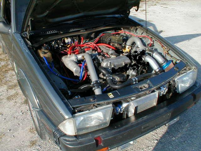

We are currently enjoying driving a Verde converted to supercharged Nord 4cyl power (it's essentially an 80's Alfa Spider engine).
The lighter front end makes the car very enjoyable. It's handling and braking are improved as compared with the V6 car, and the engine is a lot easier to work on. This may not be news to our European and Australian friends, but few of us in the U.S. have had the chance to drive a 4cyl Milano. It's a shame they didn't import the car this way because it's a joy to drive.
The engine itself is serving as a test bed for my Spider supercharger kit. It features JE 8.5:1 pistons and is other wise dead stock, including manifolding, heads, cams (U.S. spec cams circa 1977) and so on.
The supercharger kit is almost exactly what will be in the production Spider kit. The discharge port will be different because the one on this car is hugely inefficient, and the outlet needs to point another direction in the Spider anyway.
It's currently set up with about 9 pounds of boost and it performs very well.
I used an air to air intercooler, water injection and SDS fuel and ignition. The supercharger is nearly silent when off boost.
I plan to dyno it in a couple weeks and assuming everything continues to hold up, put the kit in production in a couple months. So far it has over 5000 miles of testing with low boost (5psi.) and zero problems.

Re: Supercharged Nord 2.0 4cyl (Spider engine)
Always at it Greg
. Nice work as usual.
Please supply the print outs so we can see how effective your set up is at boosting torque everywhere rather than just (potentially) selling your efforts short by just quoting peak HP and torque figures.
I'm really keen to see the overall results. Overlayed with a standard 3ltr V6 would be very interesting
Magnuson MP45 or 62? Looks 45 sized.
BTW, how do you go about tuning ignition timing without doing it on the dyno? Or do you just do a safe 'by feel' tune and wait until you get onto the dyno to optimize?
Hi Duk,
Thanks, I will post they dyno print out once I have it. I always do that. The Supercharger is an MP62, it's oversized for this level of boost, but I can bump boost up to crazy amounts if I need to.
I tune it without a dyno using O2 sensor values, feel, sound, and basic math. I keep everything on the safe side and then get it closer to max on the dyno. This works pretty well.
The throttle precedes the supercharger, which means there is probably very little supercharging whine from the air filter right?
Hi Zamani,
Throttle location is entirely the customer's choice. There are pros and cons to every design. In this case, the throttle is on the intake side of the supercharger, and that does reduce the noise. Off boost the supercharger is essentially silent. On boost you can hear it but it's not too loud. This entire system was designed to be quiet. There is a lot more to that than throttle location. I would say the on boost supercharger whine is comparable to a supercharged Cobalt or Mini.
Hi Grant,
As this is the test bed for the Spider supercharger kit, everything above the block is from an 80's Alfa Spider. That means the head, and manifolds. For simplicity the cams are from a non VVT engine from the late 70's. They are timed at the most conservative factory settings 114/114. The short block and everything below the head is from an Alfetta. The bell housing and driveshaft are also from an Alfetta. We made the motor mounts, although that was pretty simple. They are really just stock Spider motor mounts with some extra metal welded on. The only issue with the mounts is that they have to be perfect or you will blow Guibos because there is no provision for a fore/aft driveshaft adjustment as with the V6 cars. That's probably why Alfettas blow Guibos like crazy.
Overall, swapping a Nord into a Milano isn't that much work as engine swaps go.
that intercooler looks tiny. anyone with a turbo civic will laugh at that
Hi Nikoror:
It's the other end of the car most Sport Compacts get to see:) Plus, you can't see the intercooler with the grill installed, at least not easily.
On a more serious note, it's tough to tell how big that intercooler is from the picture. You can't see how far down it goes. I assure you it's plenty big enough, even for a V6. It has well over twice the capacity of the Callaway intercooler, and obviously has far more airflow. It's also has a lot of ducting front and back to force air through the core. It works very very well, and I have the temperature data to support that.
If that intercooler was any wider, fitting into the car would require a lot of extra cutting. As it is, it fits with very little cutting of the body. In short it fits easily and performs well. It's also reasonably priced for my customers.
