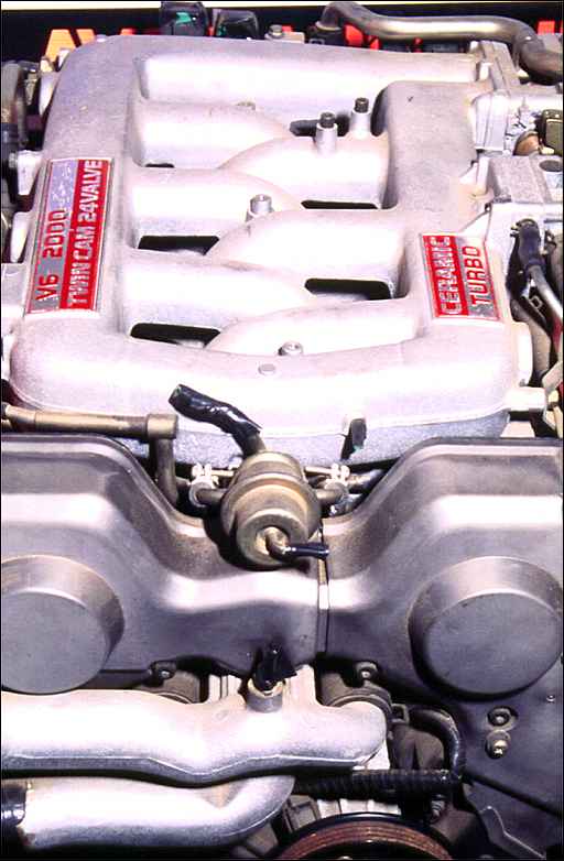

Nissan breifly used a V6 manifold design that had 1 TB but 2individual plenum chambers that were linked together at some point to achieve a broader torque curve.

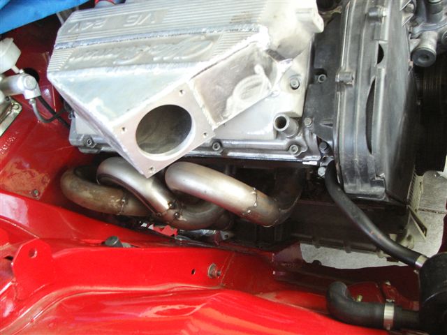

I went with the 164 style setup with a modified 164 plennum on Dads GTV and something similar but a little more modified (custom runners and bigger plenum) on my GTV
I was originally considering 2 x 164 plenums - 1 per head with 2 throttles and putting 3 pipes joining the 2 plenums (fills the spare 3 holes in each plenum and joins them to give a much bigger volume)
Headers are also a work in progress.
- Dads Plenum - fits under GTV 2.0 bonnet
- GTV3L12v-2.jpg (116.28 KiB) Viewed 26194 times
- My Plenum 1 - fits under GTV6 bonnet, not tried under 2.0 bonnet
- 090329 001.jpg (66.26 KiB) Viewed 26190 times
- My Plenum 2
- 090329 003.jpg (71.83 KiB) Viewed 26173 times

Nice work!Daniel wrote:I went with the 164 style setup with a modified 164 plennum on Dads GTV and something similar but a little more modified (custom runners and bigger plenum) on my GTV
I'm liking the dual 164 plenum you sujested. It would be excellent to compare 2 dyno runs, 1 where the 2 plenums aren't joined and 1 where they are. If there is benefits with either, and I believe there would be, then the 3 joining pipes could be fitted with a butterfly valve each and at the preffered point, opened to join the 2 together.
That 24v plenum looks to be quite huge in volume
Also as Zamani has sujested, prease be starting a new topic for the exstractors as this is some other work I'm under taking, but I'll really just be copying Jarle's design viewtopic.php?f=5&t=2116
