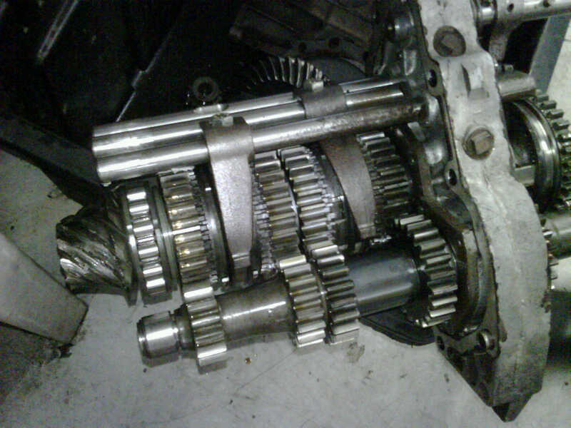

Here is that latest victim. If the pinion was the same size of the Alfa Sei then we could atleast eliminate this problem. I did have a broken pionion sent to a metal lab which as mention before they found oxidation in the root of the pinion teeth which occcured during incorrect heat treatment, as it allowed an ingress of oxygen.
The strenght was way off our scales past tool steel. Way past EN 40.
The drag racing guys here actually soften the pinions in the 1000hp cars but they only do a few runs so wear is not an issue.

interesting. Does anyonne got pictures of other failures?
And what usualy goes wrong with the pinion then?
