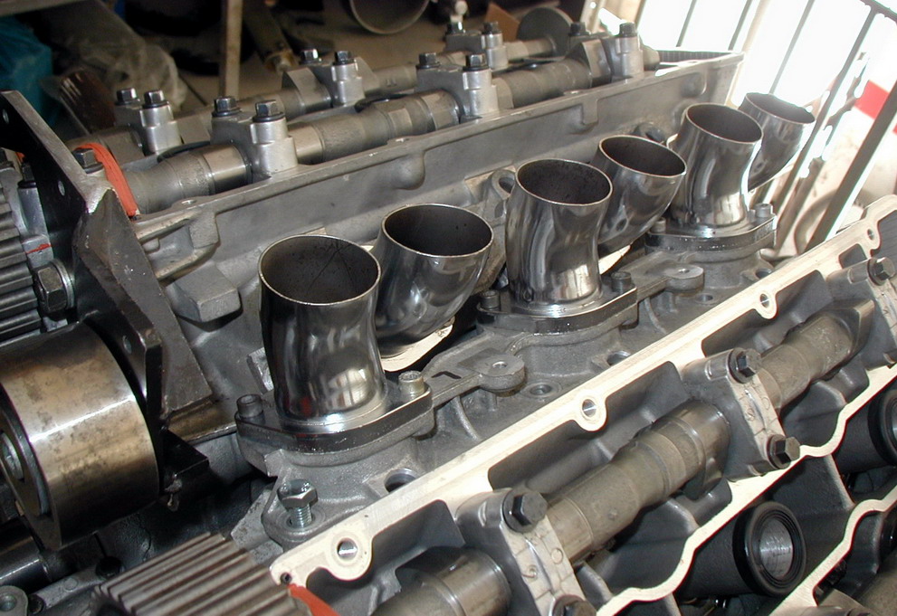

Not really too much work...all I did is cut the chrome pipes like shown in the pic and connect them to the plenum with straight Samco reducers (51/45mm). I chopped the Samcos so as to have ~10-15mm clearance between the hood and plenum. I do like the way it looks and it doesn't restrict access to the coils and valve covers. I'll post some decent pics when the car comes back from the exhaust shop.
The only additional work not evident in this early trial-fit pic, is that I ground the chrome base flanges at an angle to even out the centerlines a bit -but this is not strictly necessary.

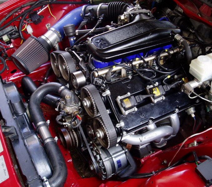

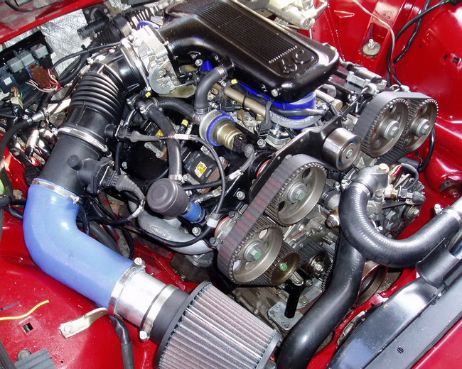

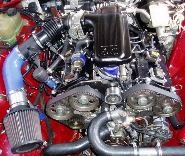

Ok, done with all engine work. The thing works and sounds great and dyno/mapping is scheduled for Monday+Tuesday. It will go on the rollers with ~600km and I suppose that's enough. I'm only concerned with ring seating before the dyno, as bearing clearances are all proper for a trackday engine and don't require a lengthy break-in period.
Here are three views of the engine.
