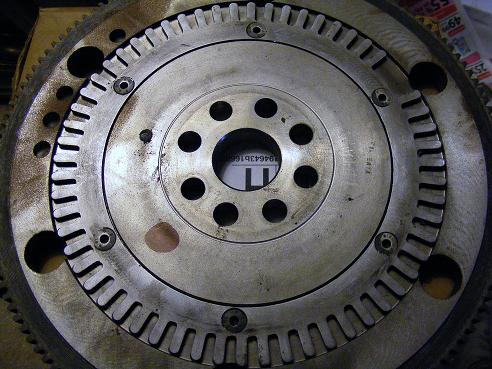

Any idea what year they changed over? where's the pickup mounted for the flywheel sensor version?kens wrote:Yes, the late Busso engines which run the crank angle sensor against the flywheel have the same 60-2 tooth arrangement.JimGreek wrote:...is it still 60-2?
I am running a 2002 engine with a 164 crank pulley and 164 front sump cover. The 164 24V front sump cover does not bolt to the pan correctly, yet, does not leak. I have an aluminum flywheel and chose to not add flywheel teeth. So, I made the newer engine run the 164 crank angle sensor setup.

The chain drive on the 2002 engine was utilized. The pan was pulled just to change the front sump cover that mounts the crank sensor.Zamani wrote:Ken,

Personally, I first see the flywheel pickup in 2000. However, I suspect it goes back to 1997 after the last 164 was produced. Someone mentioned it on the Kappa which was a 1997 release. The sensor mounts onto the oilpan or block next to flywheel.la_strega_nera wrote: Any idea what year they changed over? where's the pickup mounted for the flywheel sensor version?
The photo is a 2002 Lancia Thesis automatic flywheel.
