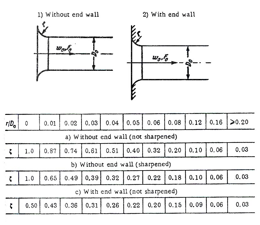

Why not attach the trumpets to the wall? The flow coefficient is better unless the inlet radius is very large . . . and then it's equal. I've attached a table from the "Handbook of Hydraulic Resistance" by I. E. Idel'Chik.
The note . . . (not sharpened) . . . refers to the edge of the flared tube when it's not attached to the end wall. If the edge is sharpened it will encourage stream separation. The eddies formed in the region of separation will contribute to a smooth flow into the tube . . . much like the re-entrant radius Mat has drawn.
BTW the V6 throttle body is 70 mm.
Jim Steck
