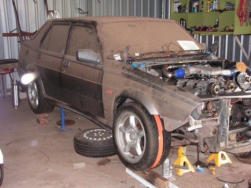

Alright, it's been way to quiet around here so I figured I'd put up some photo's of my filthy and slowly progressing project on here for sh!ts and giggles.
Engine is a standard 3 litre Potenziata motor but the Motronic has been ditched in favor of an Adaptronic E420c and distributor-less ignition system.
As mentioned in another thread, the ignition coils are Denso jobbies from a pair of Yamaha R6's
Unfortunately the heads have to come off for an overhaul. While they're off I'll tidy the ugly ports up.

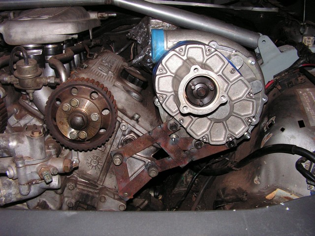

The supercharger is a Vortech V5 F trim that I scored from eBay for a good price. Definitely the worse form of forced induction for the Alfa but it should have a charm all its own with a nice progressive torque curve.
The Potenziata's have a 3.73 diff ratio, so it isn't trying to climb up the earlier 3.55 ratio as badly to find some boost pressure. They're not sluggish to begin with and lightened flywheels, specifically tuned programmable computer, tidied up ports and extractors and secondary pipes aim specifically for lowish to mid-range torque should help even more.

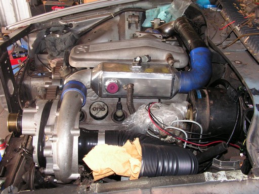

Dummy assembly shows how it will pretty much look when assembled, but will be much prettier :P

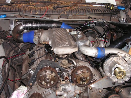

A few more various photo's:

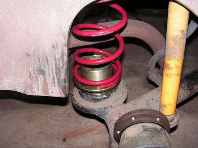

Are the front shockers Koni? What size threaded sleeve did you get, and spring size? I want to addhelpr spring for my Beninca valved Konis.

Yep they are Koni's.
The springs are Eibach 1.875" (1 7/8"). The threaded sleeves are normally marketed as being for the small bodied Bilstein's. I got them from http://www.speedwaymotors.com/. Note that I had to weld a steel sleeve onto the shock body for the sleeves to sit on and the shocks had to be overhauled after that (popped a small hole in each one when I welded it and the low pressure gas got out). The foot valves were stuffed any way 'cause the previous owner had the car set so low, the soft standard bars and no bump stops meant the shocks bottomed out internally............. :roll:
A new lower mount is required and is similar to what is used on the RSR coil overs.
I actually welded up and ground out the top hole further forward so that the spring would fit inside the box section in the chassis. The top control arm is also modified so that I can run more caster without the spring binding on the top control arm.
All in all, a fair bit of f@&king about :shock: .
