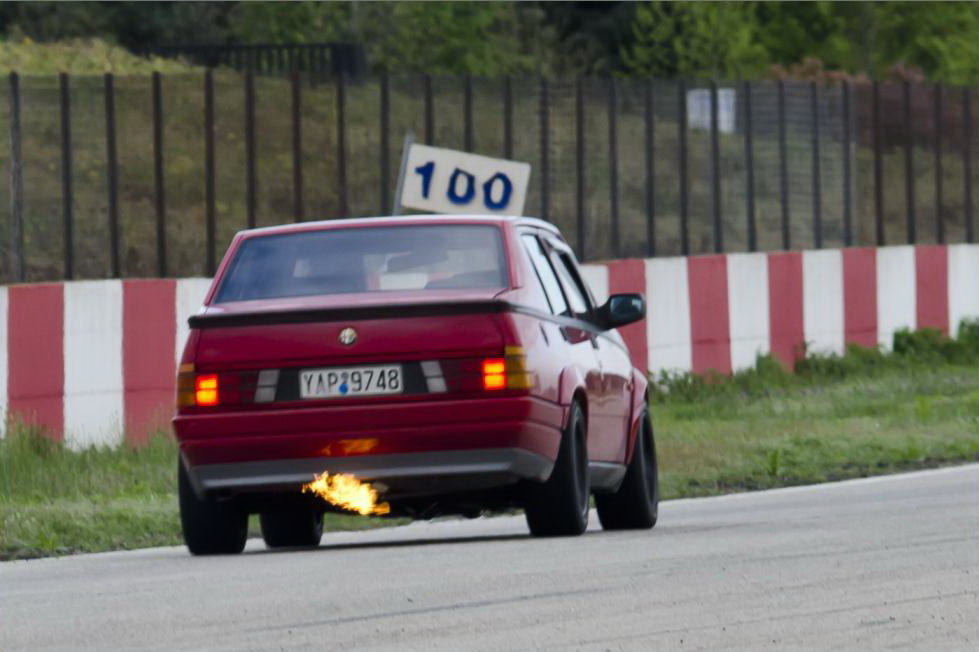

Ok, here's something for you management geniuses: for some reason, the 24v engine does not have fuel cutoff during throttle lift-off. In the track it made for some spectacular shots during shifting, when big flames shot out the back (injectors kept spraying and when the throttle opened again...boom out the exhaust!). Same thing with the spare ecu. Hmmm, this engine was in a 4wd car and the ecu received some inputs from abs and viscomatic circuits. Note that there's no TPS, just a potentiometer with no position adjustment slots ie fixed position. I do have a homemade cct to insert which will cut fuel off on lift-off, but that's not the point; I would like to know how the std 164Q4 does it! Any ideas? :idea:
The pic is from close to the end of the long straight with ~125mph during braking+downshifting.

Fricken awesome pic for the screensaver . We make those flame throwers out the side for anticarjacking here . :D
I will ask the gurus here on that issue .
