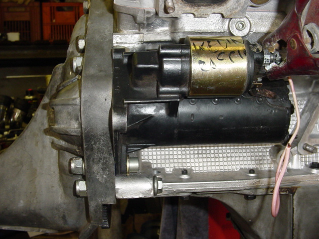

FC,Why did you not fit the gta starter to the engine??Whay better than the old clunky gtv6 starter.I have it fitted to my Giulietta and would not go back to the old starter .

- since the post 164 engine has different starter than the earlier ones, it cannot been mounted on the old bellhousing, or You have to change the front of the starter. I decided, I keep the GTA's original and can sell it to someone having any V6 '98 onwards.

Thanks for the info.Pity you did not post your problems with the std. ecu.I can remove the key encoder security issue for you..(i DENY HAVING SAID THAT......)The std. ecu is the best way to go afaic.
As for the starter,check it out .

At the starter, are the holes at right place? When I mesured I found they are closer on the old one than on the new. But maybe I missed the process somehow.

FC,The picture does not show the final result.No ,the holes are not the same-I use the bottom hole to mount the starter and then swing it closer while turning the motor(you can see the jumper cable attached).When all sounds good,I then drill the top hole and attach the starter.I then make the plate and bolt that to the bellhousing.Once that is attached,I screw a pre drilled and tapped round bar to the middle hole.I then weld the roundbar to the strap attached to the bellhousing.Simple and much better that the old clunky gtv starter.Will find my Giuliettas starter conversion.This one is on Kevins gta engine.
