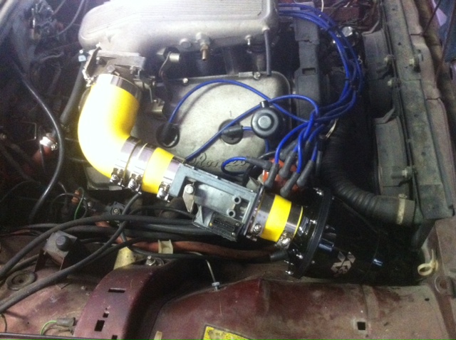

New Design, Cold Air Intakes for the V6 cars
Well, I decided to offer an actual cold air intake upgrade as an option on my intakes. We can now offer it with the K&N Apollo filter system, this is not one of the cheap knock-offs, it's the actual Apollo filter. It seals the filter from engine bay heat, and has a really nice velocity stack built in at the base.
The filter lines up with the factory fresh air duct and can be sealed to it if desired, so it's a true cold air system. This is going to be an expensive option, about $100 as the Apollo is really pricy, and I have to shorten the main elbow and vacuum port ring by hand in order to make it all fit.
Anyway, here are some pictures:

In regards to the engine vibration/torquing, is there any issue with the plastic-cannister (that the air filter is housed in) being fixed to the cold-air port on the car. Is the price just for the plastic canister that surrounds the air filter? Is this something you're associated w/if someone is interested in purchasing the unit?

Definitely the right way to go . You really get to appreciate the difference of cool air when you run six carbs and duct it all into cold air . Carbs are so sensitive and don't have the corective loop system of injection so this set up will make a big difference without you actually knowing it on the L jet system
- nice innovation without have to cut the body work and showing the filter next to the horn .

No issues there at all. The kit includes flexible ducting which can seal it to the port. Plus the filter is attached to the AFM which is attached to the body via a metal bracket not shown in the picture (but you can see it in lots of other pictures of this intake). So the silicone downstream of the AFM is what flexes when the motor moves around.alfatrapp wrote:In regards to the engine vibration/torquing, is there any issue with the plastic-cannister (that the air filter is housed in) being fixed to the cold-air port on the car. Is the price just for the plastic canister that surrounds the air filter? Is this something you're associated w/if someone is interested in purchasing the unit?

I am not sure I understand your last sentence. This is essentially the same intake I have been making and selling for about 10 years. It's just the latest update. Some people wanted a true cold air option, so here it is!

Cold air is better, but even the old version of my intake performs very well. I think my older version was the best on the market, but this new option makes it a little better.
We may put a kit together to allow users of the older system to retrofit to the newer system.
