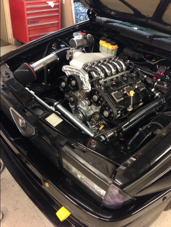

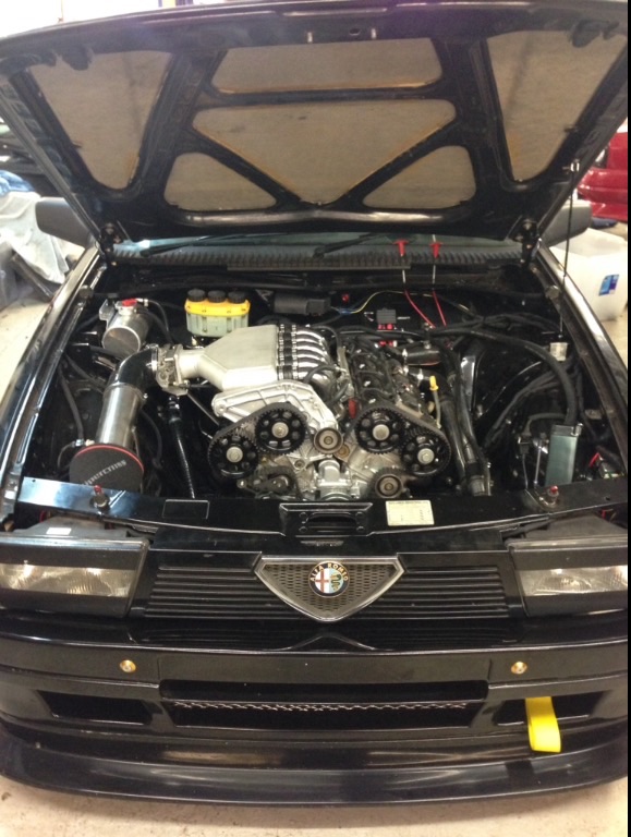

Do you know what are those headlights? Looks actually very good!kevin wrote:Just another pic of a 24v into a gtv. Nice intake .Interesting bodykit
And so does the engine bay

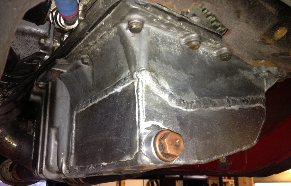

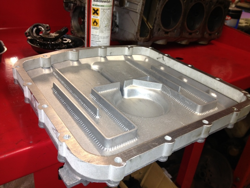

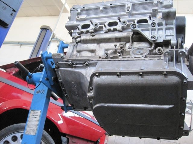

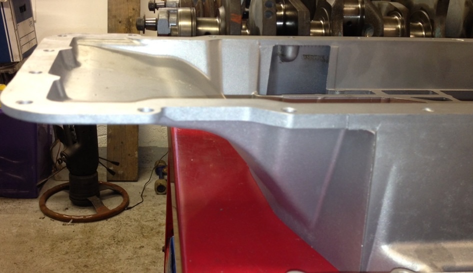

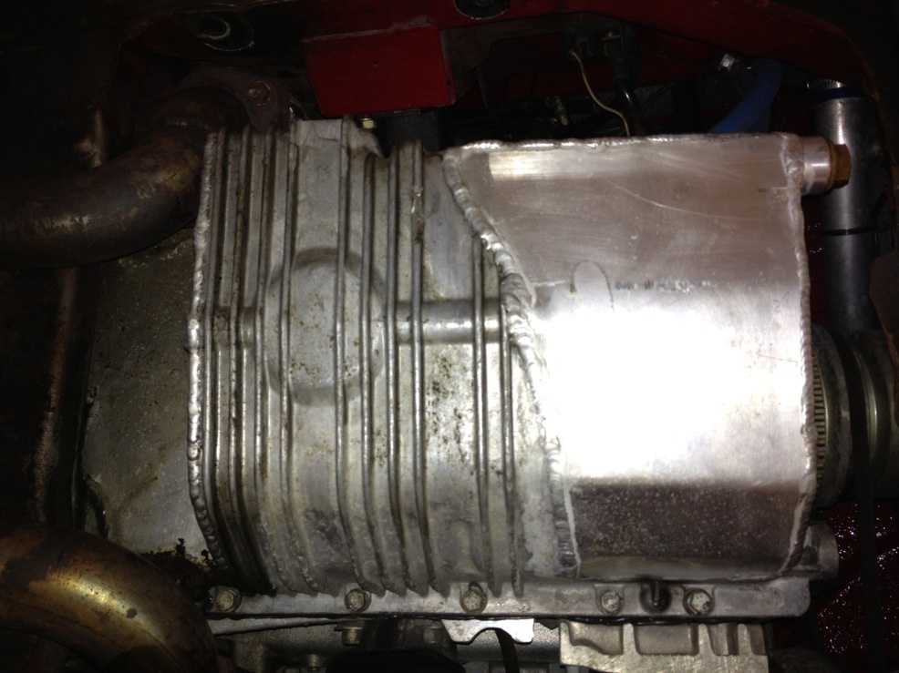

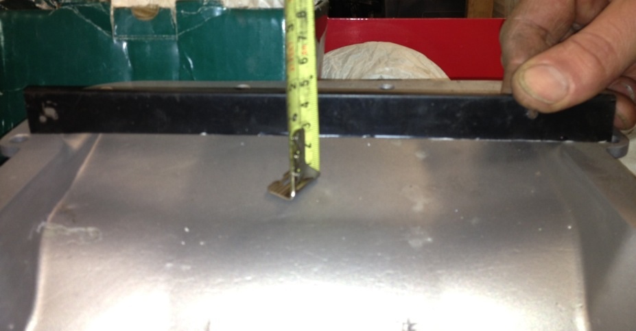

Some pics below of sump on 166 conversion into a GTV . Basically consists of two cuts and some baffles inside with plating each end . From the back of the sump to the second bolt hole the depth of sump starts at 15mm and falls to 26mm As per standard sump . Note these dims are for 3.0 while on 3.2 you need an extra 5mm as the rod bolt catches . By third bolt hole it has completely sloped in hence you can do vertical cut on the 166 sump here and it clears crossmember with space for exhaust to bend .
Some pics of standard sump alongside modified sump . Notice the shape is just followed .
Also recalibrate dipstick as mentioned previously as these motors sat at an angle . ( was a link to a thread on that somewhere ) .
- image.jpg (175.84 KiB) Viewed 17396 times
- image.jpg (181.77 KiB) Viewed 17396 times
- image.jpg (77.99 KiB) Viewed 17396 times
- image.jpg (122.5 KiB) Viewed 17396 times
- image.jpg (122.78 KiB) Viewed 17396 times

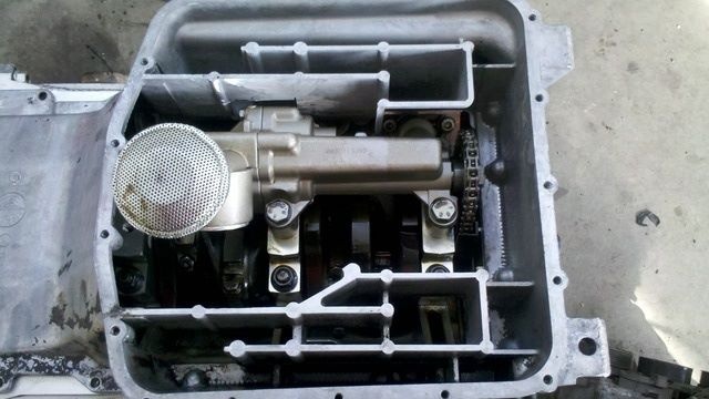

This is an alternative to modifying the sump on the 166 as in pics above. By using a spacer between pan and sump there is enough clearance for the chain driven pump to fit . Its not the cheapest and easiest as its water jet cut from solid piece and you still have to do all the bolt hole mods and taps on the 116 sump to fit properly . It does look the part though . I had this piece made when I was in SA so it was relatively cheap there .

Thanks for posting this, Kevin. I've just stumbled across a 166 for peanuts and I'm debating stealing the engine for a GTV6.
What are the chances you a lead on someone to perform this kind of work still? I can only imagine it costing a small fortune here in Australia.
Short of that, is there any way to modify the oil pump to fit a standard sump?

what about ground clearance? The lower pan will stick down lower.
Re: 166 24v into 116 GTV
Both types of sumps are obviously lower thats why its very NB to run a sump guard . However -

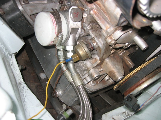

You can make an adaptor which goes on the back of the chain driven oil pump . This is quite intricate , then after the adaptor you reroute the steel tubing of the pickup, after that the standard GTV sump fits as in pic page before . . I have seen it done but no pics .
The more I did this conversion the easier it became . I'm also looking at solution of not having to tap thread into block for oil filter instead you re machine the aluminium original set up ( ie the fwd castings etc) . It might not look pretty but saves time .
Will attach pic of the area or piece to machine down also pic to show sump guard next to custom sump .

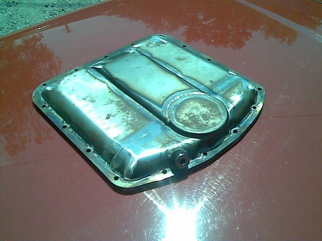

Here are also pics of a custom sump pan made by some chaps in Bulgaria which is also a good alternative to spacer .
- image.jpg (70.67 KiB) Viewed 17124 times
- image.jpg (73.54 KiB) Viewed 17124 times
- image.jpg (97.34 KiB) Viewed 17124 times
- image.jpg (119.88 KiB) Viewed 17189 times
- image.jpg (200.86 KiB) Viewed 17192 times

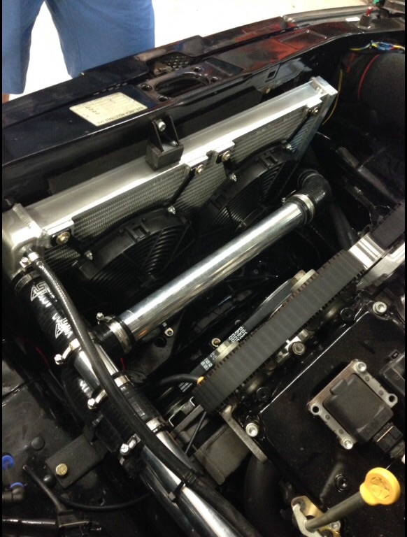

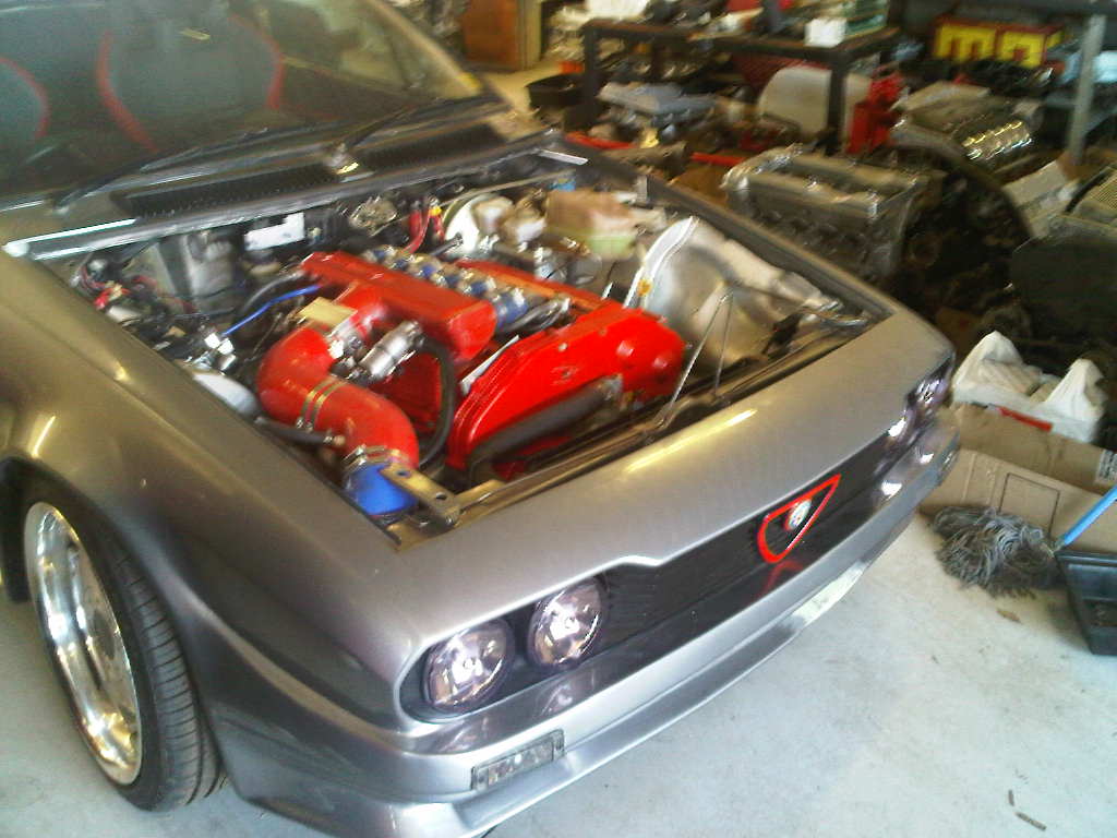

Some pics of a Friends 75 with a 3.2 24v motor . Pics show options of bringing water pipes from the back . It's slighly easier in the 75 than the Gtv due to more room but still a nightmare if you change the thermostat . Might have mentioned before that if you skim heads the thermostat fitting does not fit properly and you usually have to apply sealant to stop water leaks . ( as you skim heads the angle changes hence the spacing of the housing at the back does not fit on smoothly . Only really worry when you skim to give over 12 :1 comp)
