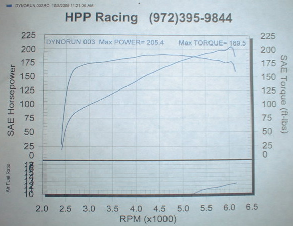

Today we dynoed SuperVerde and I am fairly happy with the results.
The 3.0 put out 205 horsepower at the wheels which equates to an honest 250 flywheel horsepower. This was with low boost (just over 5 psi) for it's trip to California where we can only buy 91 octane fuel. I am quite sure we could have bumped it up quite a bit higher if we were planning on 93 octane but that's for another day, better safe then sorry. Since this test was with a stock engine with slightly lower compression these results are the minimum a customer could expect.
We made a few pulls on the dyno. We checked it with timing at the factory setting, also at 6 degrees advanced which gave 2 less horsepower and 6 degrees retarded which gave 10 less horsepower. My father's prediction that the factory timing would be best was correct.
At the bottom of the dyno graph you can see the mixture was dead on target at 6000 rpm with an air fuel ratio of about 12.5:1. The graph also shows the great limitation of L-Jetronic. While we are able to get the full throttle mixture dead on at peak horsepower we can only move the whole fuel curve up or down. This means at full throttle it's way too rich at lower rpm. It ran super rich below 5000 rpm, about 10:1 and as rich as 9.5:1 down below 3500 rpm. This hurts the max torque output since that's around 4250 rpm. While this may not be ideal, I should point out that it's on the safe side and if you are going to use L-Jet it's a condition you have to live with.
We also experimented with mixture a little just to make sure we can richen it up enough for higher boost. That worked perfectly. Of course power went down with the excessively rich mixture but this showed the L-Jet system with my Stage 2 injectors can support 8 pounds of boost on a 3.0 with no problem.
For those who don't know the car, it's a stock 3.0 with 8.8:1 compression (less then stock actually). It has no engine mods except my supercharger kit and big injectors. It has all factory manifolds, no porting or anything else.

Supercharged 3.0 Dyno results (Low Boost)

One question: Are you expecting the car to pass, say CA, smog? I wonder if running it so rich at low RPM will cause problems with the smog? I suppose you have no choice as it will otherwise run lean at high RPM. I can already predict your answer: One setting for the day of smog, and then off to a more optimal setting
Suppose you are still not in risk of "washing" the liners with all that fuel at low RPM? What is an approximate AFR for that to happen?

Hi Jes,
First of all it's important to understand that the air fuel ratio at full throttle is unrelated to the air fuel ratio at part throttle where the O2 sensor has input. As Zamani said, I don't expect it to pass California smog since they are concerned with the visual portion of the test. As for the actual emissions comming out of the tail pipe I think they could be adjusted within parameters at idle and part throttle.
The mixture is only super rich at full throttle. I don't think there is any danger of washing the oil off the liners because it's not really that rich for very long, and only at full throttle. It's also not that rich by historical standards. Many high compression muscle cars from the carb era ran air fuel ratios around 10:1. Just how rich would it have to be to wash the oil off the liners? I don't know exactly but I do know from my avaition backround with Turbocharged 500 cubic inch 6 cylinders that it's well rich of where power loss starts to suffer greatly. When you get it that rich it's obvious something is way off, it just won't run right.
The superchager's whine is noticeable in normal around town driving. When the boost is on it's loud. In cruise on the highway you can barely hear it. It's possible to muffle the sound which is why you don't hear it as much on supercharged Minis, Buicks, Jags, etc. however I have not done much about that. I like the sound and I can't wait to hear it mixed with a loud angry exhaust system.
