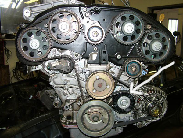

I have a question about your alternator belt setup. Is the tensioning of the belt done by the pulley with the arrow pointing to it or is that just an idler?
Do you know if its possible to retrofit one of these on a 164 24v engine?

Mike,With the setup I sent you dont need the tensioner!Use it as is and adjust from the top.Everything simply bolts on.
Besides,The tensioner will NOT fit the 164 based engine.
Cheers,
Yes, we use it as a tensioner as that is the role originally on the GTA-engine. But as long as I know, it doesn't applicable to the 164-engine easily.
