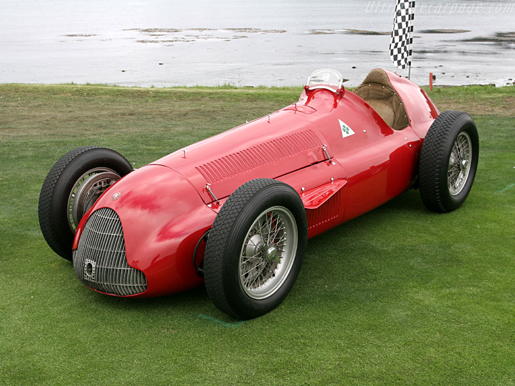

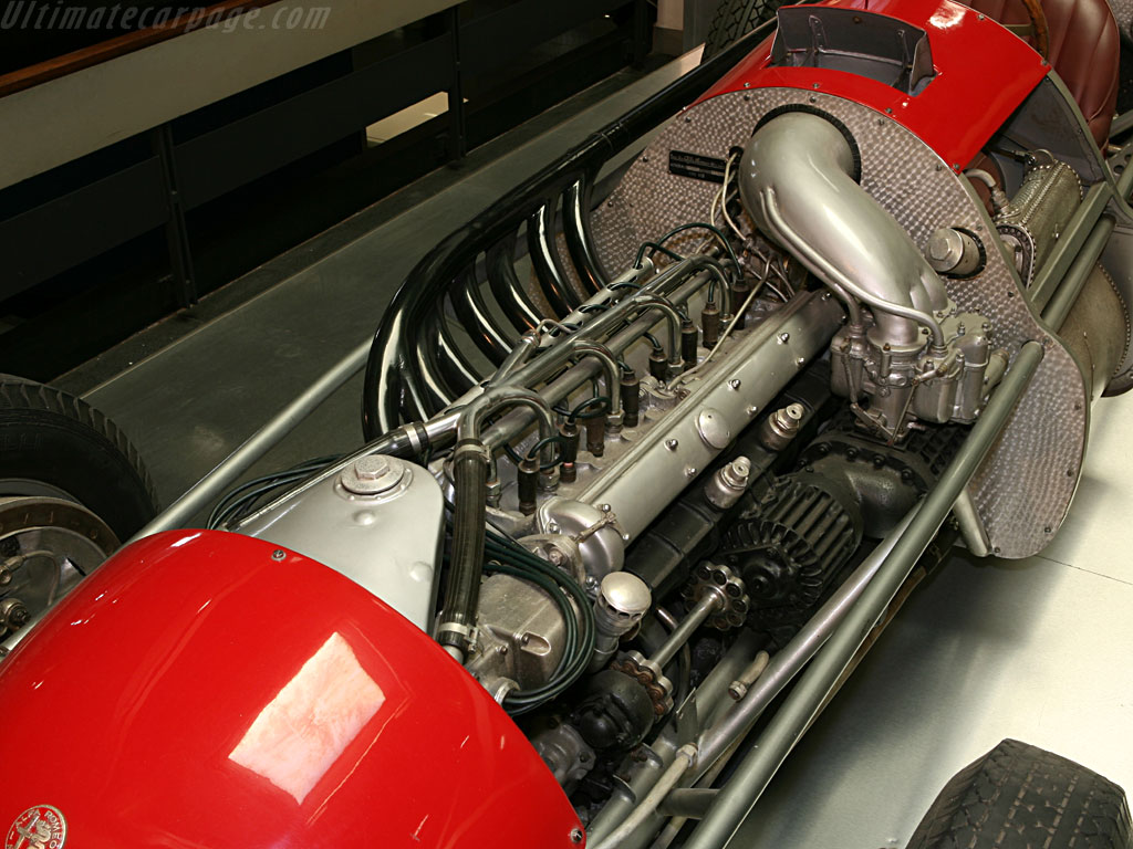

I think the title of this topic is Boost. In that context, here's a bit of boost info for ya. I think you will really love this one Greg.
We all think getting 100bhp/litre is pretty good going. Try 287/litre way back in 1951. Wow 425 hp from 1.5 litres.
What a pearler. Check her out. Absolutely magnificent. The 159 Alfetta. A true champion.

An inline 8 8) would love to hear that at full tap :D .
100hp/ltr, maybe an achievement for some, but others have bean providing that for 15 years or more.
200+hp/ltr in a road going engine is an achievement.

Not just an inline 8. A supercharged inline 8 :D
People just don't realise how advanced cars were back then. Heck could you imagine doing 220km/h in THAT! :shock:

Is that a fact? Might be for the later 4 valve units but you show me a typical 2 valve road going Alfa engine and I'll show you a baloney sandwich. Granted that she is supercharged and that would make the difference in any engine.
Hey Rooks, you're short changing the old girl. She is quoted in some specs as capable of 305-310kh. She also had two superchargers. I think they were sequencial. So how fast are the current formula 1 cars going, hahaa? :D
Thanks for posting those pictures, I love that car, and so far have never seen one in person.
That 159 Alfetta is one of the most successful racecars of all time. It uses two Roots superchargers to develop over 30 pounds of boost resulting in well over 400 horsepower from it's 1.5 Liter straight-8.
There are two things that make this engine fairly unique. First, although it's a straight-8, it actually has two crankshafts that joint together in the center. Power comes out of this motor from this central point, not from a flywheel at the end of the engine. Most straight-8s can't rev, but this design allows the narrow frontal cross section of an inline 8 cylinder engine with the high rpm abilities of a tiny 4-cylinder.
The second unique factor, is the dual supercharger setup. By using a slow turning large supercharger blowing into a fast spinning small blower, they were able to get 30psi with far less heat build up with a conventional single blower set up. This dual set up keeps the pressure differential across the rotor pack in the second stage blower to a minimum thus reducing slip.
i once read a test in a magazine where it was compared on track to a 155 V6 TI ( 155 DTM car, 420 bhp). The 155 was miles ahead in the brakes and cornering department but was nowhere in outright speed and acceleration.. 8)
4 gears and depending on rear diff it reached up to 310 km/h. it used Metahnol or something as fuel and a lot of it also... 1 litre for 800 meters or something :( . the tankcapacity was something like 300 litres. :shock:
Very impressive car. 8)

Thanks Mats! Do you have more of those? I have been having a hard time finding technical drawings of that engine.
I just stumbled across it, totally unrelated. :shock:
So no, I don't I'm afraid.

That 159 is beautiful to say the least! Thankyou for pic!
And Greg thankyou for the tech specs on the Chargers,fantastic. :wink:
