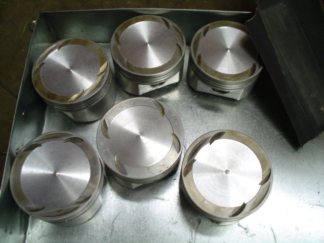

Greetings Mats,Yes .the std Alfa piston works well.Im busy with a 2.8 tt at the moment and am using 164 24v pistons in the 12v engine .This motor will see 1 bar all day long .Cr 8:1 on a 12v.

- Dsc01032.jpg (142.25 KiB) Viewed 12890 times
hey barry,
those 164 24v pistons? on the 2.8 are you going to do anything about the grooves for the valves?
or are they going to be jus a stright fit in?
