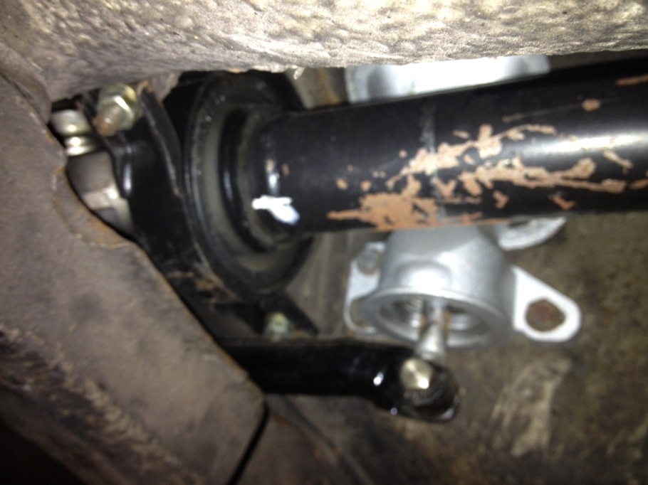

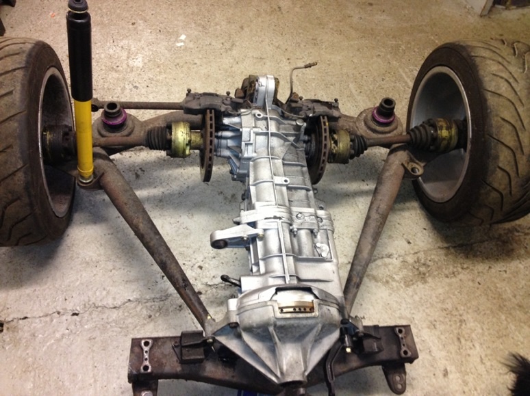

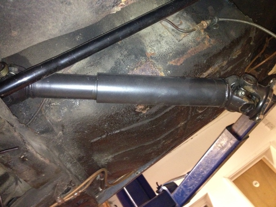

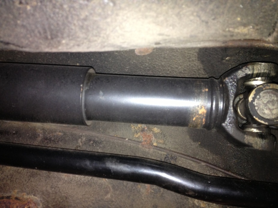

On page 6 the discussion was around gearbox and prop modifications linked to a company that supplied these parts http://www.artracing.co.uk/parts-and-services/
I saw track car that was in for and underbody service etc which had this kit on . Its runs a 24v motor and get pretty much thrashed . Thought I would add it here to keep the thread discussion .
The interesting part on the prop which has three u/j , is the rubber filled dampening section of the prop which I believe or has been mentioned already comes off an Aston. I did try twisist by hand and you can feel the feedback from rubber .( fractionally ) Its the smaller tube thats rubber moulded into the larger tube .
See the pics which include the reinforced clutch housing .

Looks like a very nice solution but expensive.. Keep it in mind.
Does anyone has experience with welding on the clutchhouse. Can it be welded?
Maybe i can reïforce the original just to play safe. That's a small job compered to the cage construction and a littlebit stiffer becuase there's no play. I know aluminium gets soft when it is welded. But it's a self healing material. Afther a few month it's in the old state again. So after the winter over here

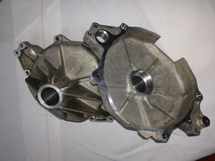

Richard Melvin sells an uprated version for 675GBP.
- Richard Melvins uprated clutch housing.

Kevin also uses a nice solution for reinforcing the housing... the steel cage that fixes the snout of the housing with the mountingpoints to the gearbox, like a steel spiderweb.
