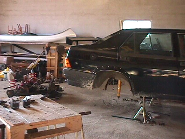

Lots of good points flowing here.
Back to my flat underbody. Making it totally flat is almost out of the question. However, any improvements here are really worthwhile. The Katz book is good, as is Hucho - Aerodynamics for road vehicles.
As Mats said, when you play with the airflow under the car you MUST consider heat issues.
When I made the front of the car flat the engine and oil temperature jumped a huge step on the scale. Actually enough to be a problem (solved of course).
What I did:
Flat plate under front air dam
Flat plates in the entire middle part between the skirts
Rear venturi as wide as fits between the tires
Tricks:
hot air from radiator is ducted 100% out through the FRONT of the hood (you're right as usuall Barry)
cooling air is ducted to the engine bay, oil cooler, oil pan and good care is taken that the hot air can escape without restriction
the exhaust is heat shielded (rock wool) and the tip exits through the sideskirt
the vented rear disks are not covered. The plates have holes for the hot air to escape. The rear brakes have cold air ducts as well.
the gearbox has cold air ducting and hot air escape (together with the brakes) above the venturi
the bottom is made of a combination of plywood and aluminum depending on how hot the place is.
there's still work to do but the concept definitely works. If anyone of you owns a wind tunnel we can make a gettogether and do some serious testing ower a couple of cold ones.

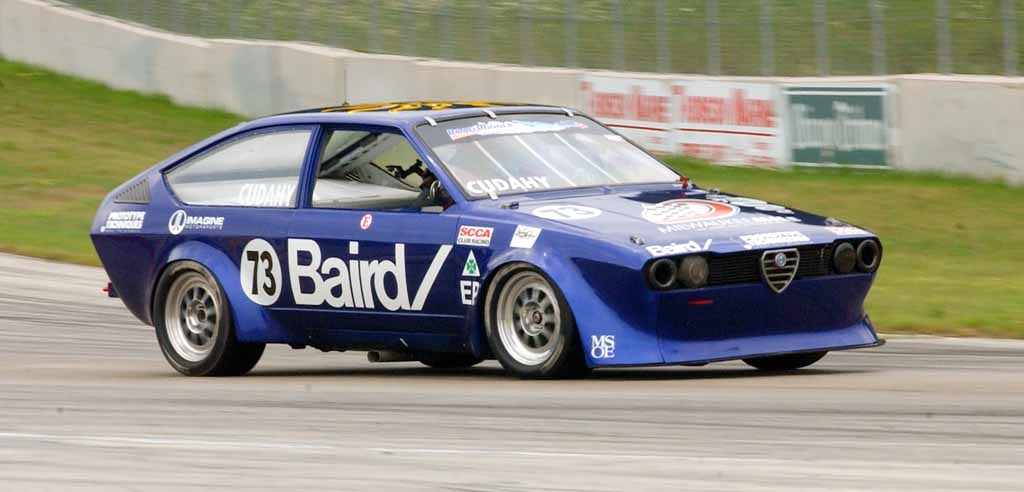

Speaking about the effect of the aerodynamics....
IMHO the answer to Zamani's original question is that with a small splitter and a wing off the shelf you do not get any gains you can feel.
In one race (first trial with my new - rear biased at the time - brakes) I managed to spin at ~160 km/h. No damage and I continued the race.
Next corner I spun. Weird, I thought.
Next one almost again....
Damn, are my tires muddy or what? Then I heard a new sound - WIND. I had lost my lid backing up.
Without my rear wing I was not able to do a corner at ~100-120 km/h without spinning. After this experience I can definitely tell you all IT WORKS!!

Define "big turn"
the larger the radius (= higher speed) the bigger the effect of aerodynamics.
The effect is proportional to the speed^2.
I.e. if you have 500 N (50 kg) of rear downforce at 100 km/h you will have 4 times more or 200 kg aiming into the Schwedenkreuz with 200...
From this you probably also notice that the impact is bigger for light cars. My GTV weight on the rear wheels is 480 kg and YES, 50 kg of downforce makes a difference.
