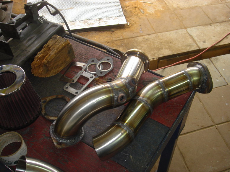

The new downpipe is almost done now...I'm a bit uncertain of how to exit the wastegate-either it will dump to free air after the sump area or connect it to the 90bend on the beginning of the downpipe.
P.S almost forgot I need to weld two bungs for Wideband and Narrow band Lambda sensors(damn!)

The final downpipe design.
