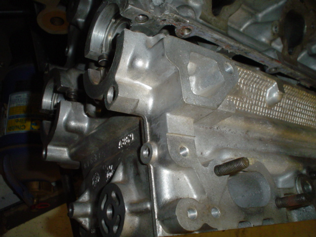

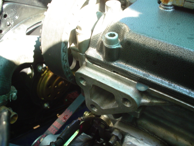

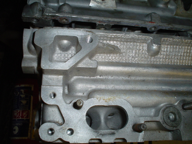

I will see if I can find a 24 valve motor to look at. I doubt there are any in the Dallas area. I really just need a good photo of the front of the left head and the outboard side of the left head, and the block in those areas. Plus the crank pulley.

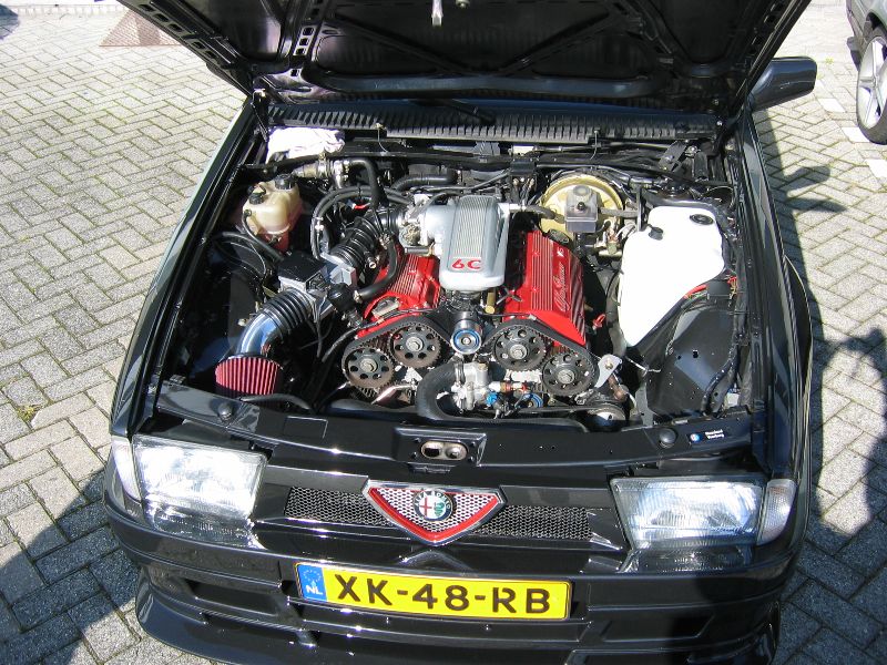

Crank pulleys can be different on 24V Milano's .
Some people use the multi belt pulley others use the QV(motronic) pulley and i 'm using a 164 V6 12V pulley.
I probably need to move the PS pump. In the current situation my pump and mount are positioned even higher than on a 12V standard V6.
At this moment i don't have a better pic.
Greg what do you think of the rotrex compressor?
155 3.0 V6 24v Q2 NovaCorse
I don't see any big problems there. The power steering pump looks OK. The windshield washer tank will have to be replaced with our little one. I can't tell what that alloy structure is that sticks up from the power steering pump, it might be in the way.
I still need to see a detailed close photo of that area behind the left outboard cam pulley there may be a minor problem there, and a good photo of the left side of the head and the pulley.
From what I can tell it's not a problem, it may be a little non standard but no big deal.
