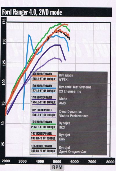

Same car, but different dynos
Example of dyno reading variance.

Great example Zamani, if this isn't confusing I don't know what is! What will this owner say when asked about power? "somewhere from 130 to 180"? :? :shock:
