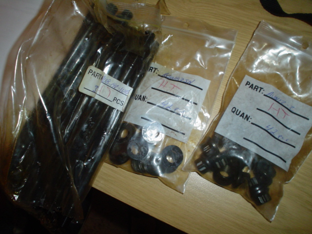

You can custom order them from ARP direct..
I sent them a sample of the 12v and 24v studs and they made for me..
They have the data on record so ordering for an Alfa should be no problem..
I can vouch that the ARP stuff is way better than the Alfa stuff..I must also say that I only use the ARP stuff in severe performance engines..
You dont need ARP stuff in any n/a application imo..

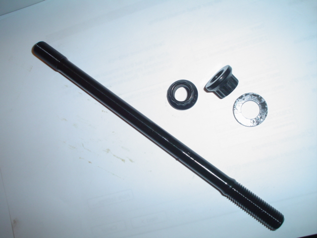

Ive only still got 24v studs left..but work on std. length and threads etc...
What you will receive will have metric one side and metric fine on the other.
They come with lovely machined washers and nuts..
8)
