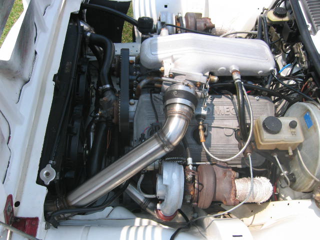

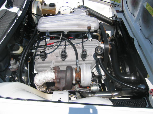

Hi Garth , even with good plennum rubbers the plennum used to come off and only at the worst possible moment just when you are trying to gap to big trucks up a mountain pass !! All the chaps here have flexible brackets back to the cam cover. And when that does not pop off then the intercooler pipe pops out plennum.
Check it out.

Re: Adaptronic...? Dizzy? Adaptronic to the rescue!!
Cant see in this pic but will try find another later.
Found it
