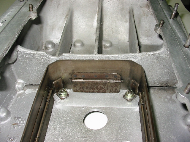

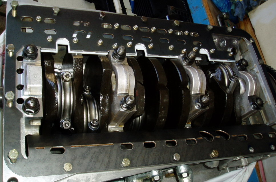

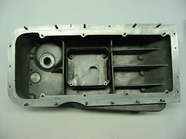

Slowly progressing with the new 12v 3liter, reason being the special valves I'm expecting from G&S Valves in UK. In the meantime, I trial-installed the crank scraper I got from Ishihara-Johnson. Nice sturdy piece of metalwork, needed a few minor 'fixes' to fit properly. The maker has been alerted and will correct as required. I trimmed the Teflon sheet as best I could and its very close to the rotating parts, as intended. I may be breaking some new ground here as this installation will seriously reduce 'flying oil'. Will this result in higher temperatures?
Notice proximity of Teflon sheet to rotating parts.

Why not a thicker material and double its function as a block girdle? Especially for a 7K rpm engine. I suppose it's not a problem until you reach > 7.5K?

I'll only talk about the big-bores when this motor goes to the dyno. I haven't been able to solve the injector cutout problem in the current engine and about the only thing I haven't tried is reverting to the old CSC setup. if I can't dyno, I can't assess big-bores, simple as that. Now, what does the injector drive signal have to do with headers....forget it, I don't want to get back into this, I've given up! The show wil continue with the new engine and that's that!
A block girdle is a separate item which can be built and will bolt on all main studs. its difficult to make the scraper thicker as you'd be lowering the oil sump and altering oil pickup/sump bottom distance.

Z, A thicker scraper would not be very effective.
Image Image
This will only alter the b in the equation.
This reinforcement baffles idea is good, when altered nicely... so that the main studs also bolt on to them.
That would give more a lot more stiffness.
When tying both sides together you are actually altering the h in the equation!
This is the theory, if it can be done in the oil pan? I know the 4 cil have baffles in the pan, interference?.
General info:
A folded plate has stiffness in the direction of the fold. And a thin sheet is very stiff when loaded in its plane.
Try this at home with a thick paper sheet :lol:

I would think there's enough oil for the bores being thrown out of the rod bearings to take care of that. The design of the scraper can't stop that from splashing around.
Re: In the build...? Anything new being done..?
If there is a measureable temp difference I'd be surprised. The plus for the crank scraper is thet it gets windage oil off the crank (not all mind you) and therefore horsepower that was taken up in spinning all that oil around goes out to the wheels. The question becomes is that difference measureable on the dyno?
The oil being down in the pan instead of wrapped around the crank is likely a plus when you go around a corner and the oil sloshes to one side.....there is more there to cover the oil pickup.
Yes, that is the case for the scraper. If I believe the various sources, power gain can be up to 3%, which isn't bad in the over 200hp range.

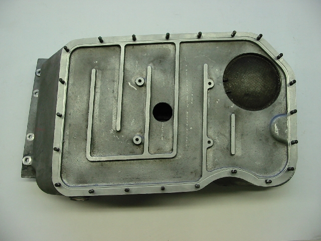

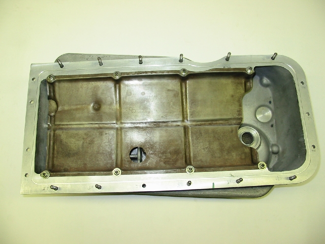

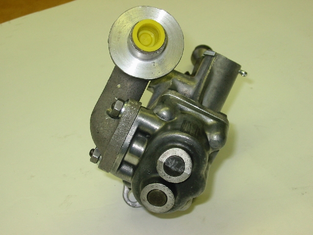

To complete the oil control subject, a better baffle is needed, like a plate bolted horizontally on top of the sump paritons, with holes for the oil to flow down. This plate will not allow oil to climb to the sides of the pan/block during cornering. I have this item half-finished and will soon post pics. My current puzzle is where and how big to make the holes for the oil. I already made the minimum required opening for the pump to go through -so small, it requires juggling and twisting the sump around it to make it fit!

How about just 40-60 mm from the side walls of the pan, some slits of 3x30 mm
Baffle not completely horizontal but bent a little inward towards the slits and the bottom of the pan.

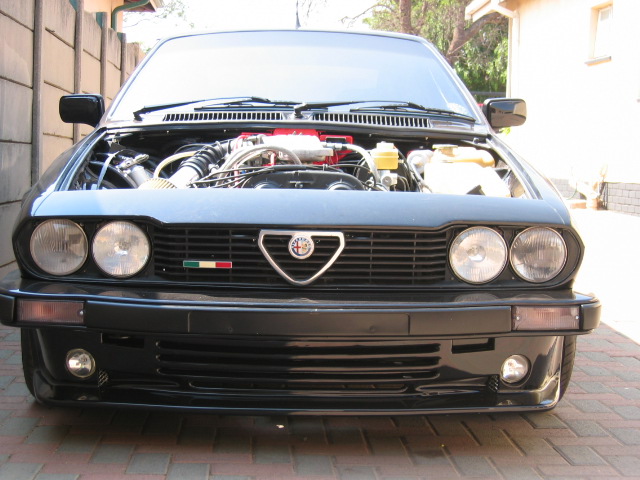

There are four very interesting projects here. Currently starting to build a 75 3.0l 12v milano motor for racing but it will be in mild form looking for more torque. Hopefully I will find easy power in the fuel management side like I did in the 164 's with the removal of the restrictive AFM. Once the ''book'' is on the shelves then we can start looking back inside the engine.
Here is a pic of another road project .
