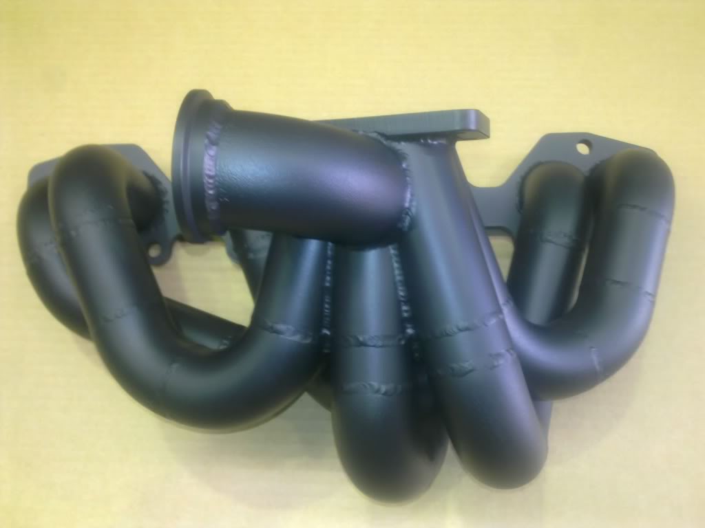

Not to mention the packaging nightmare with two turbos on the same side of the engine.la_strega_nera wrote:They go a single because a good modern single is very responsive, and a darn sight cheaper than buying two decent smaller turbos...GarthW wrote: Ben-yeah they go single because there straight six engines...a V6 is simply better suited to a twin i think.
Nice pis mate, very nice fabrication.![]()
Ok, thanks for the help y'all. I'm gonna keep single configuration, and if that dont do it, i'm going japanese, nuff said...i want big power lol.

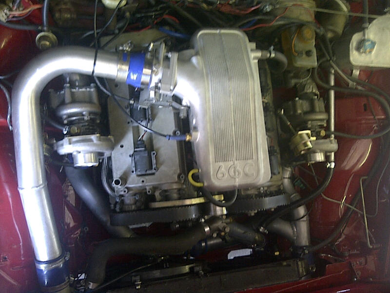

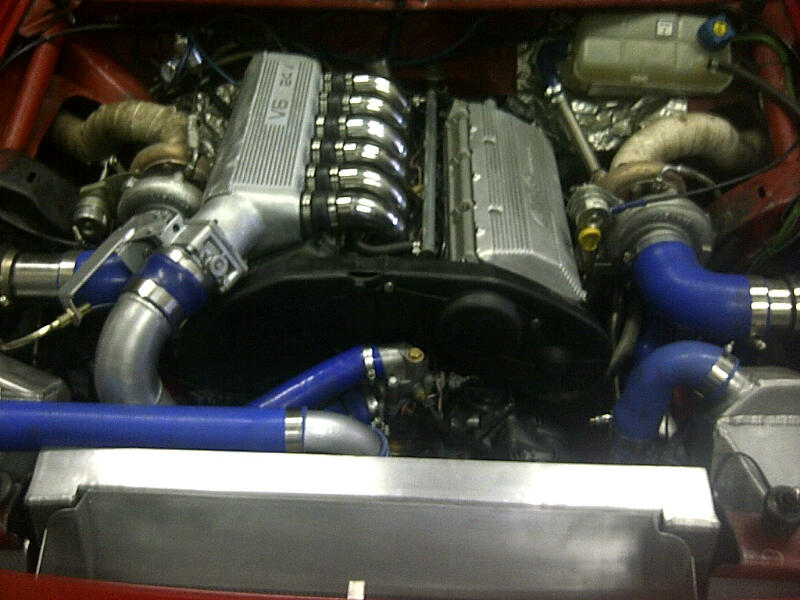

Some Pics of two GTV that have been tested at the garage at the track . Very neat work . Owner of the one is ex member of this board . Maybe he might surface . Their has been big effort here in strenghtenning the transaxle box. The TT with normal exhausts is a road car.
- glenwoodtt.jpg (76.42 KiB) Viewed 9711 times
- fernando_tt.jpg (81.06 KiB) Viewed 9711 times

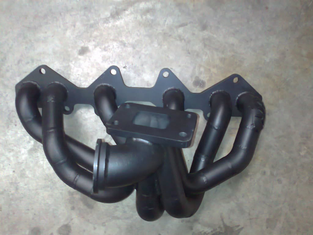

- Photo0113.jpg (72.92 KiB) Viewed 9701 times
- smallrunners1.jpg (68.76 KiB) Viewed 9701 times
- Image0185.jpg (41.04 KiB) Viewed 9701 times
