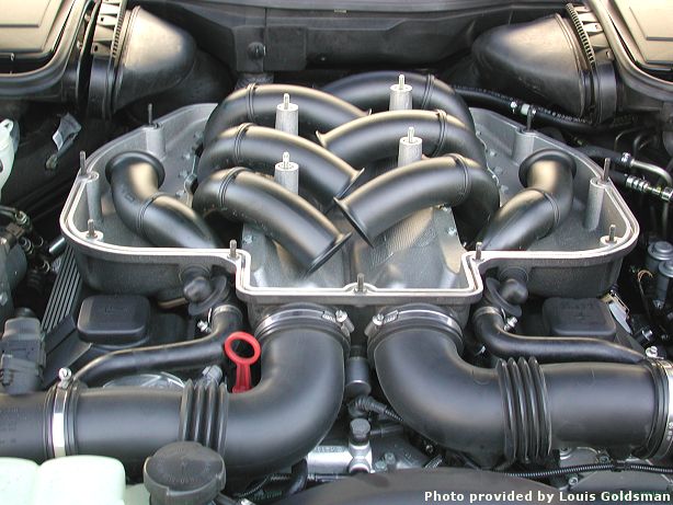

Something I found a while ago. Bmw M5 intake.

Interesting, though-
look how long those runners are-
If you put some numbers in B&G's calculator, it looks like you need a 21" runner to get a 10% pulse strength in a usable RPM band. Wonder how long those M5 ones are.

Ohh..... I tried to read all about this subject until my head almost fell off.
Jim's example would make sence according to formulas. I'd try 20 mm trumpets and perhaps just for curiosity (if they fit) some 140-160 mm trumpets as well.

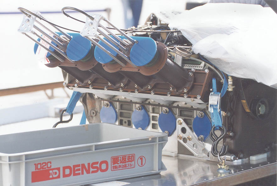

Here's the variable intake that Mazda used on the GTP cars in 1992. Took this photo at Sebring.
Jim Steck
bteoh
Posts: 211
Post by bteoh »
Yeah, I believe that was the 26B quad rotor engine used in the Mazda 787B in Le Mans.....

Hmm just had an interesting thought that hadn't occured to me before. The M5 has individual throttle bodies I assume, now being a V8 that would be enough tb's for 2 of our 4 cylinder motors. Anyone got a wrecked M5 sitting around? :)

Guy have a look at BMW bike TB's. The one's fitted to 1200 boxer engines (RS 1200)(GS1200)
Carel
It would however mean you would TB's from two bikes for one 4 cil
