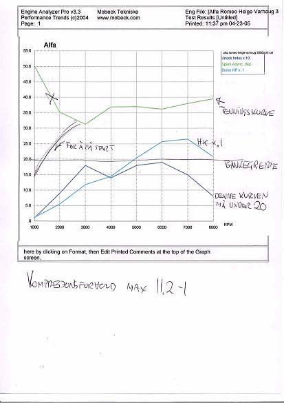

Post by Jarle »
Here is my calculated ignition setup:
Ignition AR 3.0 V6..JPG (32.08 KiB) Viewed 11215 times

Guys are you saying that you're setting STATIC advance at these values ? If so what would be the impact of cranking my 2.5L L-Jet up to these values ?

Zamani, I would guess that the 5700 is measured by the dyno counter and not your tach...?
Any way, 28 degrees seems to be the 12 valve target under full load for max power. (Had this conversation with Domingos (GoTech) a week or so prior and his maps too seem to all like 28 degrees avance at full load!)

Post by Andrew.b »
Z
In the GTV-6 factory handbook (uk) it shows 31 degrees maximum advance. "M" mark on the pulley??
And 6/8 degrees static @ 800/1000 rpm
So I guess your safe with "up to" 31 degrees.
just play around on the dyno with 3 or 4 small changes to full load max advance power runs, and see what gives you the most bhp - overlay each run to see what works. Say 28-29-30-31 degrees, and see if the power starts to fall off at 31.
Try to run with setting just before power falls away. Were you runninng with high octane fuel in the tank?? was the tank full ??
