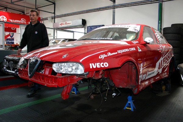

junglejustice
Posts: 624
Location: Granolaville, WA
Here are some pics
Post by junglejustice »
Sorry guys, here are some pics....

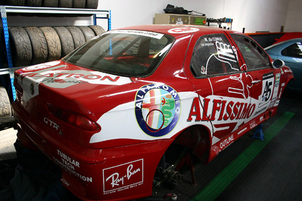

junglejustice
Posts: 624
More Pics
...and some more....

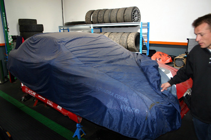

junglejustice
Posts: 624
One more...
last one.....

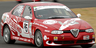

I'll be getting some updated shots when I am there in 2 weeks....
Basically, we are taking her back to the 2003 LG colours - like in this shot - from the pre-Alfissimo 2004 days...
