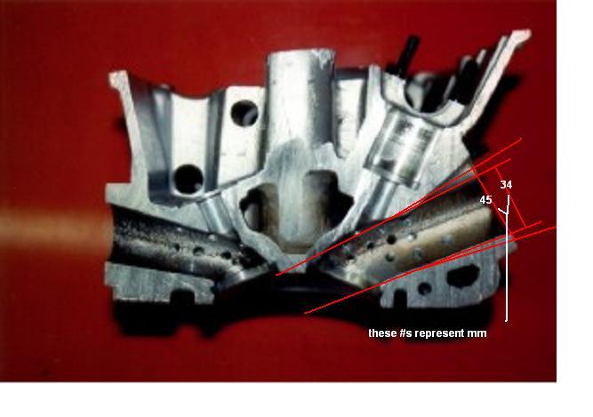

The chisel hasn't hit the marbel yet Jim. What are you saying my out come is going to be. These do originate from Dawie, and Sperry use to use them. Info me up Jim
Drive'm Hard
Take it at face value, top 50mm, bottom 38-39.
Not much more to say now, numbers don't lie!

Jim I know you the manwhen it comes to Alfas.
I'm only trying to learn as much as possible.
This is/was my plan.
Will this not maintain air velocity?

You're a few months too early with all this, but if you did the head that way, you might as well use it for an anchor! DON'T touch the bottom!
These are all 3 liter values I take it, or ar they usable on the 2.5 too?
Like I said, don't touch the bottom (short side) of the ports. You wanna do something constructive? Build it up with epoxy ~1/4" in the middle, so as to form a nice long hump. Thats all you'll get without pulling teeth!

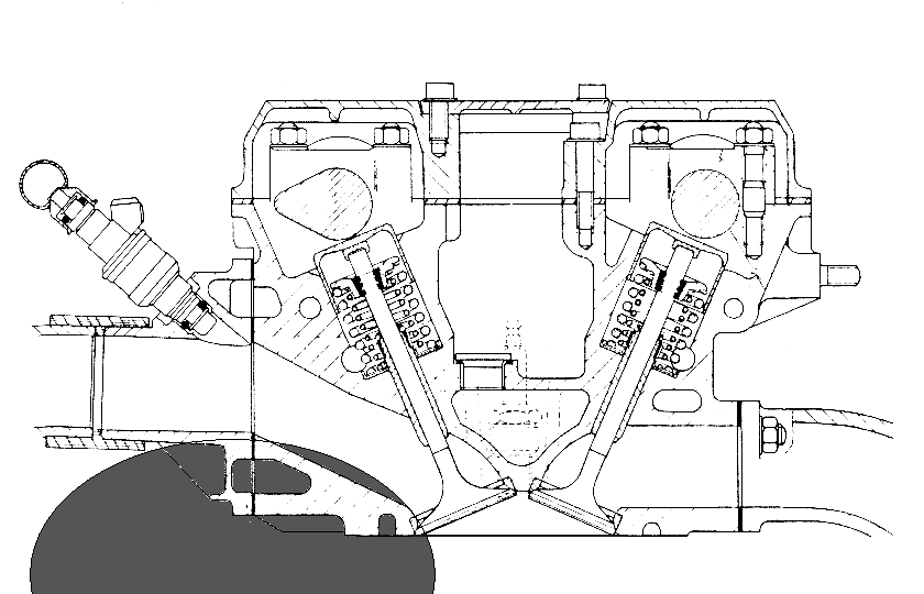

Jim for epoxy thing u mean increasing short side radius as posible ( from cutaway pic it seems very bad) to prevent flow separation and turbulence in this point .. this pic is not v6 but is just example of increased
low radius :D

Yesterday I played around with the old desktop dynos program. Its way to primitive to model real flow but was interesting. I entered the 3.0 v6 parameters including cam seat to seat timing and lift. But get this, altering the cam timeing plus/minus 1 degree dropped several hp both ways! To me that means the program, and the alfa engineers, seemed to be on the same page so to speak. And know what they are doing. The program also seems to indicate the stock valve sizes are pretty good for a 7k redline street motor. The engine model sure did respond to greater lift though. I tried 11mm intake and 9mm exhaust lift and gained a lot. Selecting the ITB intake also make a big difference. Of course we know who is in the details.... Related to this have any of you folks ever read Kevin Camerons article in cycle world titled "Intake flow 101" ? He conclued that the high velocity part of the intake duct/port length only needs to be long enough to contain 20-30% of the cylinder volume (for 120-130 volumetric effeciency). The same article says the velocity needed to do this is about 650fpm. Upstream of this the duct can enlarge to lower flow restriction.

TS Turbo, thats exactly what I mean, and its applicable to ALL Alfas, 4-6cylinder!

epoxy
What kind of epoxy would do the trick. Any experience with a specific product?
Devcon Liquid Aluminum is great for the job, as are all similar high metal content 2-part epoxy adhesives. Good for intake ports only. For exhaust ports you can only weld alloy, but you will face a number of problems having to do with lack of operating room and needing many brief welding cycles (to keep temperatures down) Gains in this area (exhaust)can be substantial.
