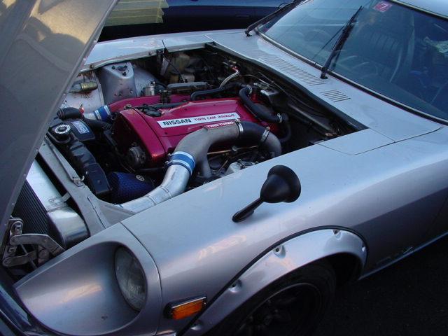

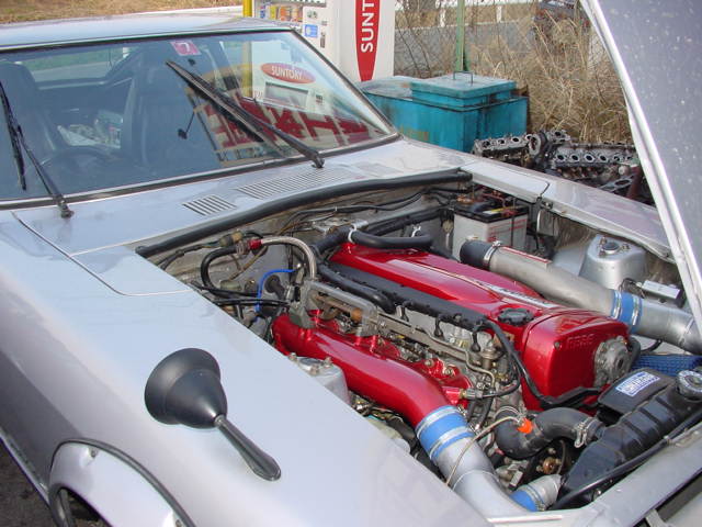

Did not know where to post this but I needed to share this with you guys-Remember that we did not get the gtr skyline in S.A.
The 200sx fitted with the rb26 engine -stock std internals-has just cranked out 514 wheel hp on 1.4 bar boost!!!
Do you know how much you have to do to a 24v Alfa to get this reliably????This thing is the most fun you can get with a car -you do need a tyre sponsor though.

The motor we have here is a cutout from the land of the rising sun and Is fitted with a single turbo and Haltech management.The latter was fitted here.
285hp-wheel-at 0.7bar boost-93ron octane
514hp-wheel-at1.4bar boost-102 racing gas.
I believe the owner wants to see what the limit will be on 95 unleadded for daily driving.
I tell you unashamedly that I want an r33 or r34 badly!!4wheel drive .4 wheel steering.Street cred to die for..
Check out back copies of "Turbo and hightech magazine"
- Heavymods1.jpg (60.54 KiB) Viewed 12079 times

Greg,
You are right, we did not see the RB25 or 26 family here is the states. The Z cars here used the VG30 DETT engine.
As far as the Toyota v Nissan motor... you will get camps arguing for each. Both, in my opinion, are very well engineered and robustly designed for a street motor.
Here is more info than you probably wanted...
RB25-DE
Type: 2498cc EFI DOHC 24 valve 6cyl
Power: 134kW (180hp) @ 6000rpm
Torque: 225Nm (166lbft) @ 5200rpm
Gearboxes: RWD 5-Speed and 4-Speed Auto
Source: 92-95 Cefiro and Skyline
RB25-DET
Type: 2498cc EFI DOHC 24 valve 6cyl turbo
Power: 187kW (251hp) @ 6400rpm
Torque: 295Nm (218lbft) @ 4800rpm
Source: 1993+ Skyline GTS-25t
RB26-DETT
Type: 2597cc EFI DOHC 24 valve 6cyl twin turbo
Power: 208kW (279hp) @ 6800rpm
Torque: 368Nm (272lbft) @ 4400rpm
Gearboxes: North-South AWD 6-Speed
Source: Skyline R32, R33, R34 GT-R's AWD, Stagea
VG30-DETT
Type: 2998cc EFI DOHC 24 valve V6 twin turbo/twin intercooled
Power: 208kW (279hp) @ 6400rpm
Torque: 388Nm (286lbft) @ 3600rpm
Source: 1989+ 300ZX twin turbo
-Brian
PS Japanese manufacturers had a gentlemans agreement to not make a motor with more than 276BHP... the HP figures shown for the turbo motors is shown lower than actual in keeping with said agreement.
