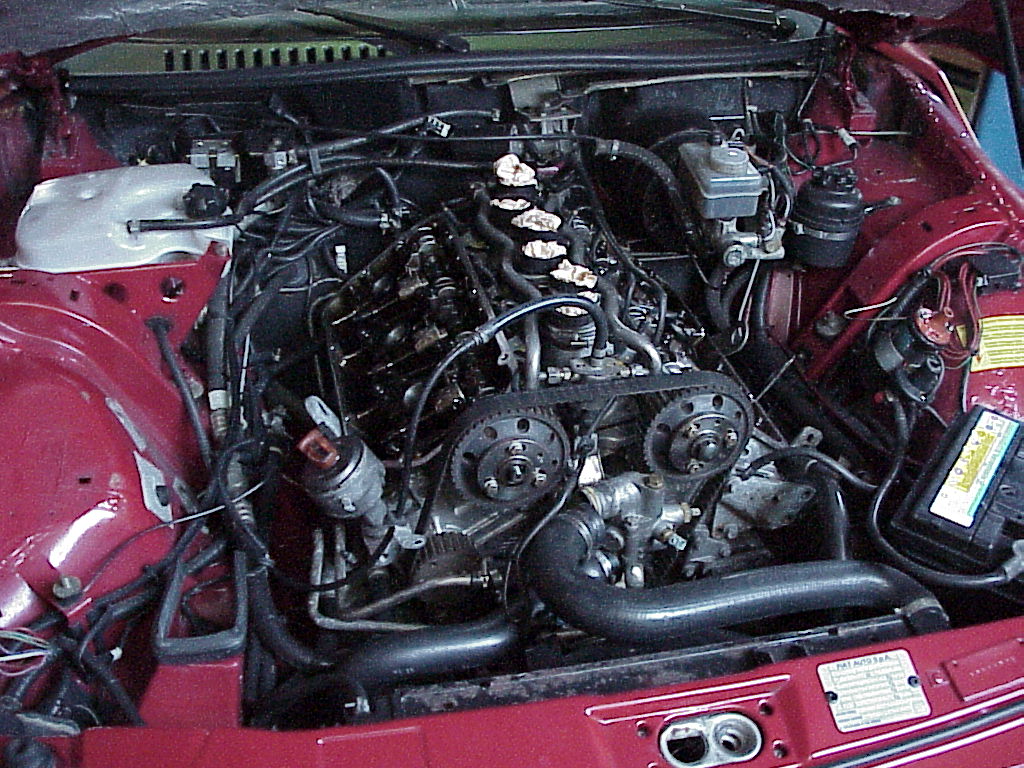

hi all, i own an alfa rz with a 3,0 litre V6.i bought the superchargerkit from greg and never satisfied as i am, want to make different piping.does anybody know if the inlet system of the alfa 164 with the chrome pipes is higher than the original milano inlet tract???i don't want it to hit the hood!!
