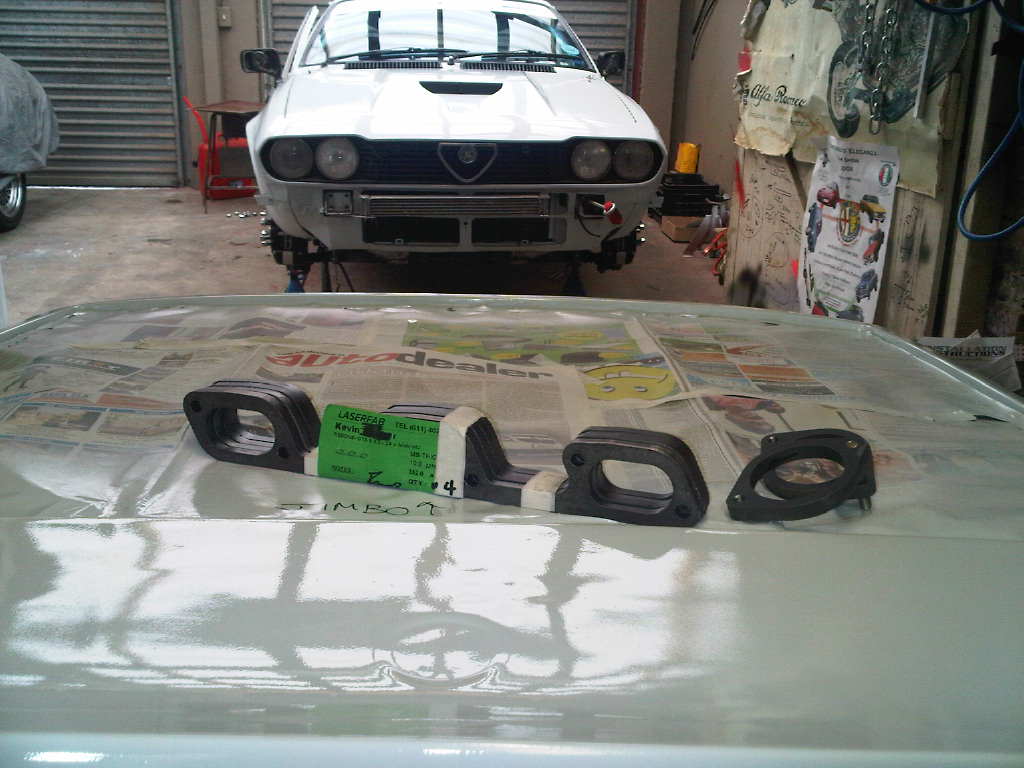

Hi Jim, sorry so slow but only got the laser cut flanges back Friday . I will get them made up this week. check pics. i have also got gaskets for them. (no , they dont have any overspray on them _ used as paperweight)

Hi Kevin, like I said there's noooo rush! Things are slow in summer anyway! Don't worry; take all the time you want!

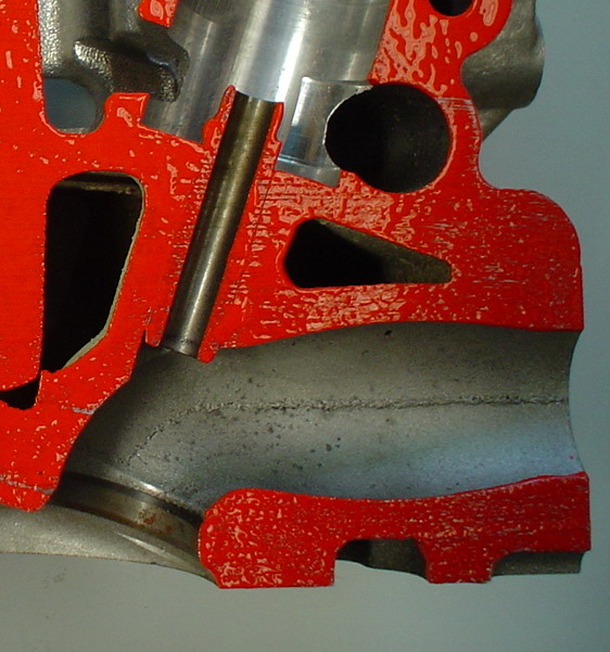

Have you guys thought about the entry geometry issue on the V6 headers as described in Jim's 4cyl book? It seems to me that the holes in the flanges that line up with the exhaust ports need to be cut at an angle so that the exhaust doesn't need to change direction as soon as it exits the exhaust port in the head. At present I don't have a good way to do this, the water jet machine I normally use can only cut at a 90 degree angle.
Re: JK's v6 book
Greg, I am a bit puzzled here. Both the 12v and 24v heads have almost straight-out exhaust ports and whatever headers are available, fit well with the regular 90* cut.
Have a look at the cutaways below for both heads.
Unless you mean something else? :?
