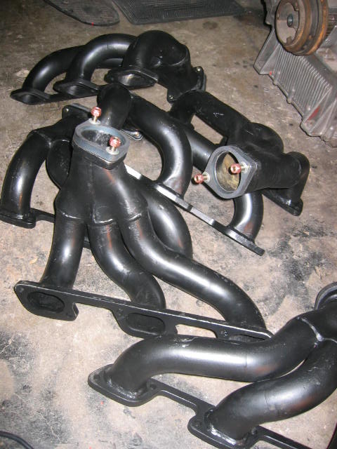

with regards to exhaust, are both engine mounts same thickness and are they in equal positon. If they are its easier to heat body and tap it in other wise you must take headers off and bolt them down before you heat and bend them , also not to difficult. They should fit as those come off my jig and they clear body by 10mm.
The engine mounts are brand new and I checked the mounting positions. I have to remove the engine one more time so will try bending the manifolds - its a pity because they have been coated already and the heat will probably spoil the finish.

Michael, surely the flanges on the headers have thread tapped into them. Dont ever weld studs in. Strip it and then you are in big s!@#$. Maybe a small tac weld on a stud thats splipping on its thread in emergency cases but not on new stuff. If they coated then tap the body in(not ideal but not going to make any difference). My new bearings corroded while the engine stood for a year . Take them off and spin them. Dont clean them with any fliuids(petrol) then they start to make a noise. Look new to me. Dont turn those engines backwards with those tensioners(new or old).

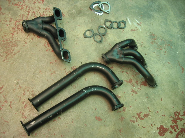

Post a pic of the down pipes JJ sent you. If its the ones im thinking of they need to be cut just after the bend, probaly 150mm. They do work just need to be cut at the correct lenght - not on header side.

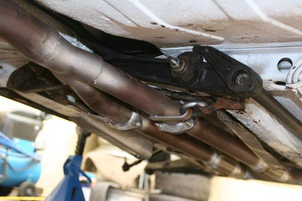

Michael, I will post pic of where i put flexis in but im not sure where you guys put the cats in. Those down pipes you have are perfect once the flexis are installed(if its the same ones Im thinking of) as this what they were designed for. The flexis here cost the same es the headers themselves hence they were not included and also every person has own ideas where they should be. send me a pic so we can help you get this baby on the road. Its the most awsome experience revving these 3.0 24v motors up to 6500-700rpm on the track in a gtv. You gonna love it.

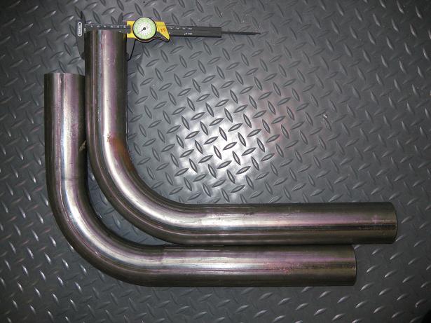

Kevin - I have attached a pic of the downpipes. The OD is 63mm.

Sorry, those down pipes are not mine but you can still use them. Just cut them after the bend and use flexi. Did your headers have a spare set set of bottom flanges attached to them. These would be for the down pipes. If you know some one here I can give you a pair as I cant post any thing overseas. I will attach pic as these are from the laser company even though headers are different.
Just found a pic of down pipes. Even though it shows flanges on both sides ist still meant to be cut.
