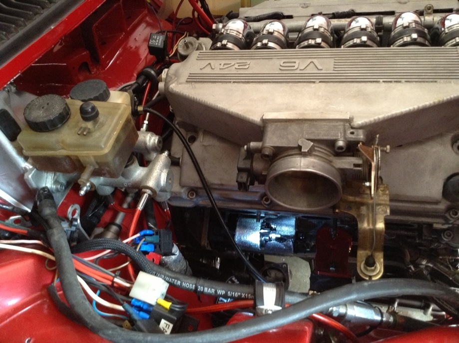

Re: Jim K. 3.2 engine
Nice pics Kevin! This is exactly what I've been doing for the last couple of days! I've been dealing with the cable issue and decided on the gtv6 metal bracket and cable routing, that is, the cable coming from between the chrome pipes under the plenum. Its a bit tight but I think looks neat.
I want to support the plenum with two nice brackets which will mount on the existing valve cover holes with rubber isolators and M6 bolts. I believe it will also look good and I will be able to post pics maybe tomorrow when I expect it will be all done before painting. I also squeezed the idle motor next to the TB. The 164 cable bracket seems huge and I opted not to use it, since the TB itself is from gtv6. I like the fact its smaller than the 24v on the outside but with same ID. I will have to make a simple small sheet aluminum adapter plate though for the TB potentiometer, as the two gtv6 mounting holes are farther apart (made for the larger TB switch).
I'm slowly getting there. When I'm done with this plenum, I will make an oversize gtv6 plenum (cutting/welding two std ones) with proper size pipes underneath. I intend to compare performance (dyno) with each type and see how close simulator results are to the real world. 8)
Hhahah! I pi$$ed them good allright, on and off for a week and then some, morning and evening. But in the end they found peace and I finished my stuff! Too bad the color (electrostatic paint) doesn't bring out detail but you can see the basics. Notice the metal plate holding the TPS. With the given TB, its the only angle possible for mounting it. These coming days you will also see the enlarged rwd plenum. I will have to visit my header shop, to have him make 6 proper runners using the mockup I made for the ITB's. All in all, its getting close to finishing time meaning: fill with oil and pressurize! Just give me a couple more weeks.
