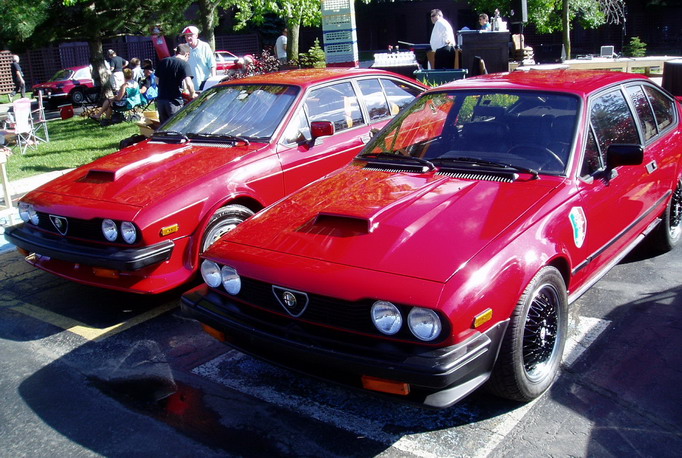

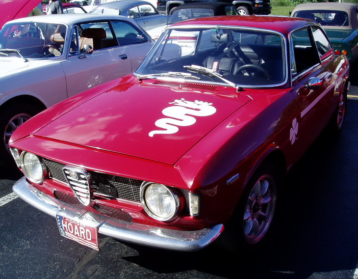

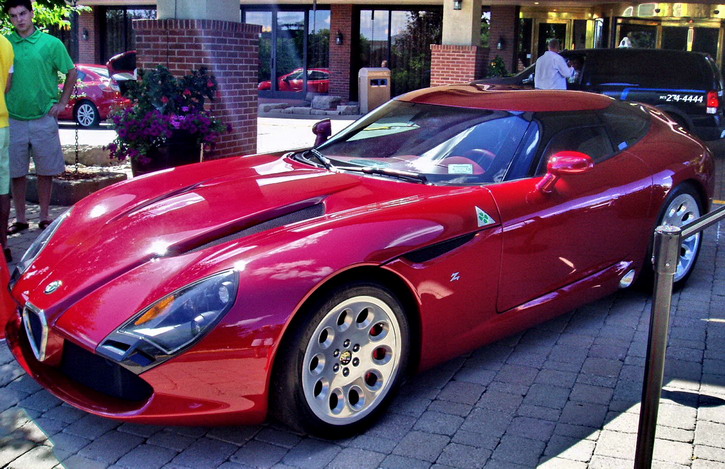

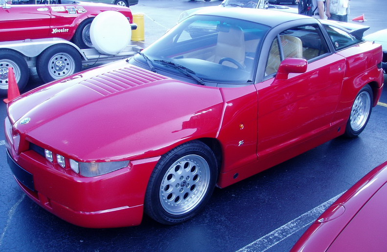

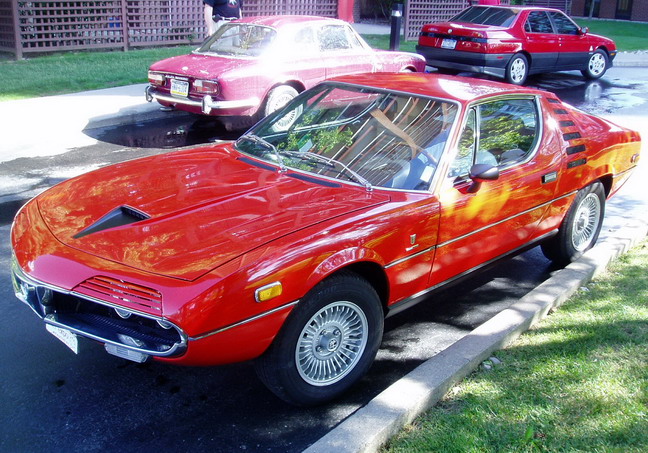

Well, I'm back in Greeceland (unfortunately) so here are some pics of the Convention, showing the TZ3, SZ, two Callaways, a Montreal and a GTA. There were more than 150 perfect Alfas of all years and models there but I was most impressed by these.

Nice pictures! The red Callaway with the Maratona kit is my customer's. It's in my shop getting some performance upgrades right now. Forged pistons, modern engine management, and other basic stuff.
