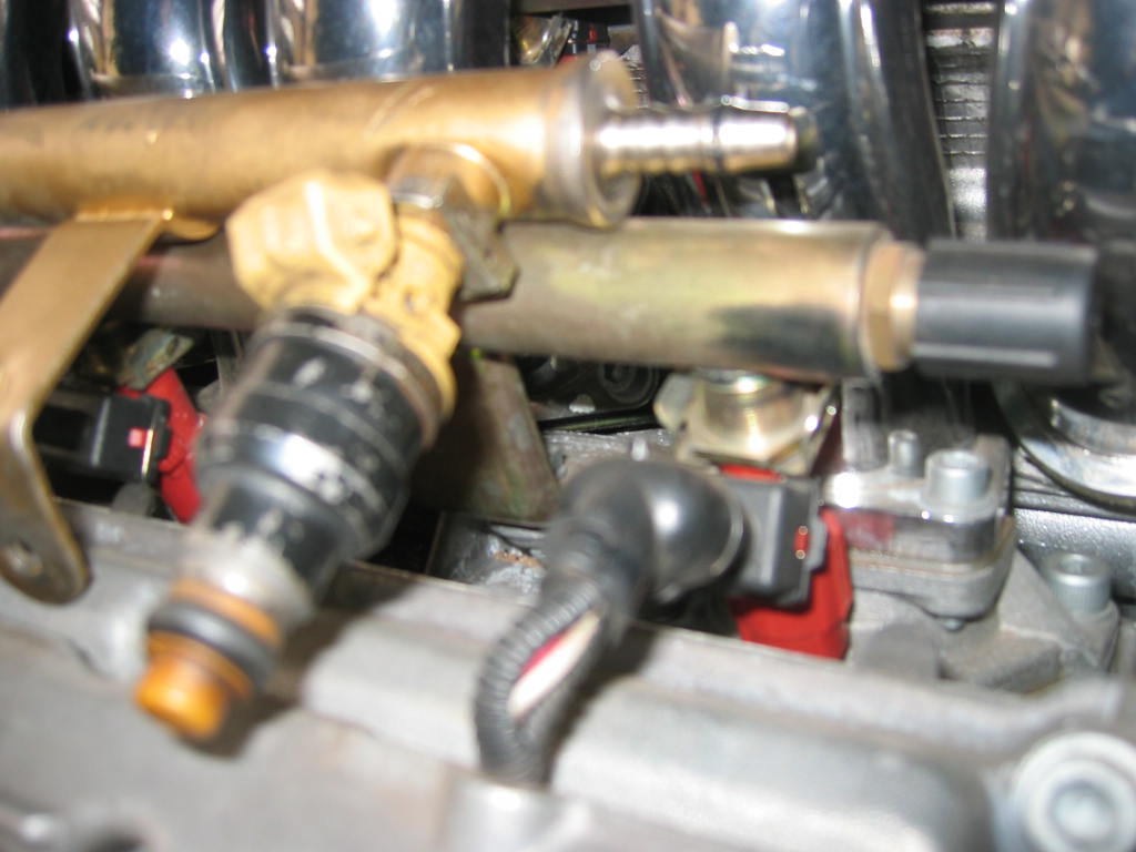

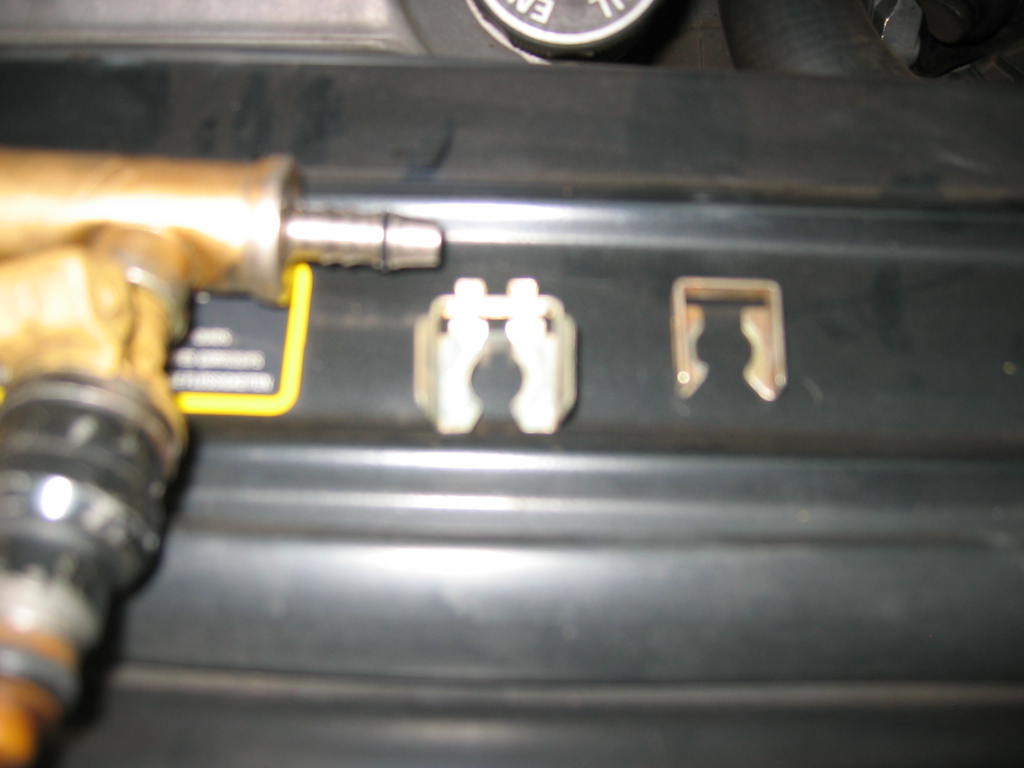

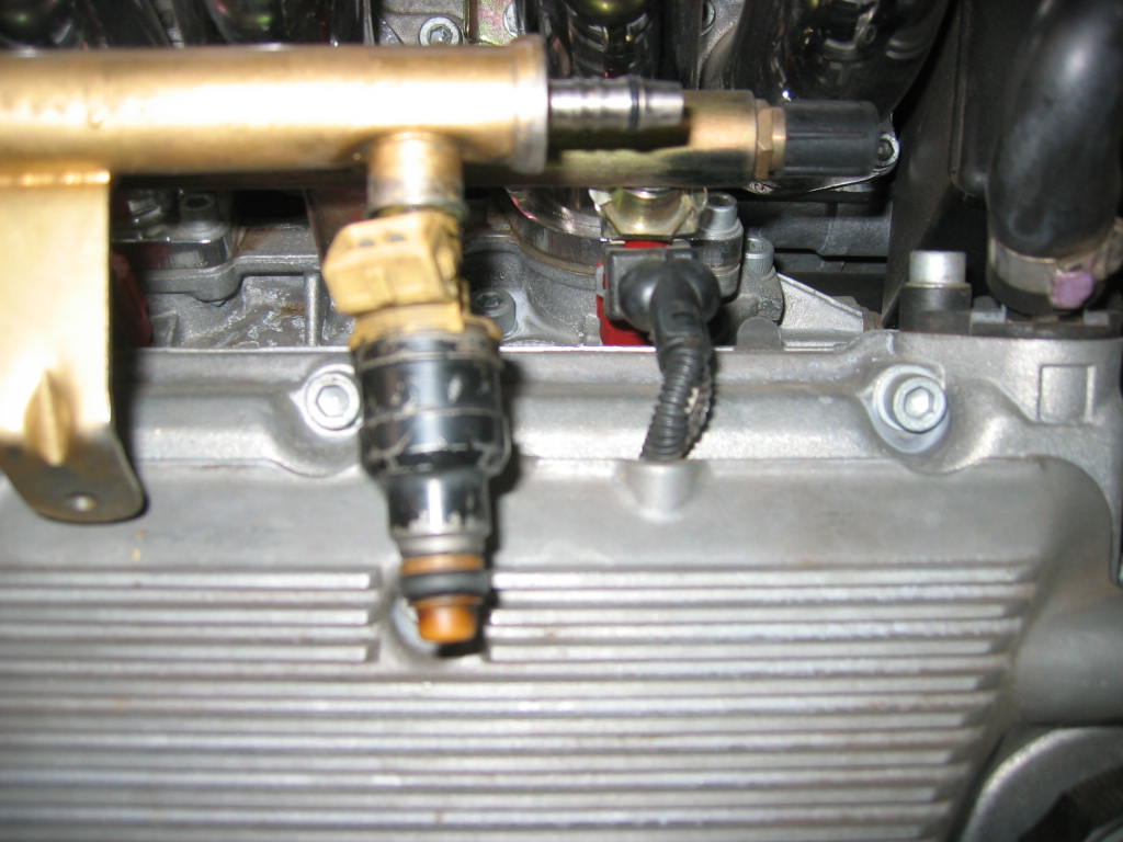

Just some pics of the difference in clips which you will see when yours arrive. I did not realise that alfa used the gta injectors on the last of the 3.0 spiders. You must create a loop system with the fuel like on 164. The later fuel rails only had one line in with the pump in the tank.
- IMG_3029.JPG (84.89 KiB) Viewed 8434 times
- compareinj.JPG (93.11 KiB) Viewed 8434 times
- clips.JPG (59.07 KiB) Viewed 8433 times

No, I was trying to show the clips are so different they can only be used with the rail and injector it comes from.Its iether one or the othe complete. As your engine has been standing long time I would take all plugs out and check compression as I have had a valve which has got stuck in guide (rust) which can catch you out.
When using GTA rail you would have to unscrew the one end of rail and put a nozzle to you can create a ring feed. If not sure I will send you a pic. But just get it started. The tps is not eeven connected on race but that is semi sequential. However it is connected on full sequential and cam angle sensor on 3.7 with latest gotech which only came out three weeks ago. So in your quest of replacing and finding parts keep an eye out for cam angle sensor for long term upgrade. You can remove that welsh plug with out taking engine out.

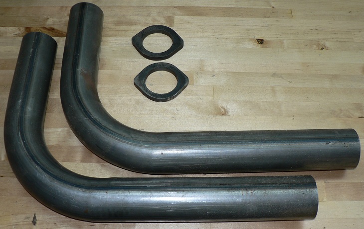

Here is a pic of the downpipes I was supplied with. The bends are not mandrel bends - I'd like to see if I can get something which will flow better - stainless would be good too!
What I plan to do this week is find a good custom exhaust shop in Seattle and then have the Alfa trailered down there.
On the topic, I need to close on an exhaust design! The X pipe is a given...
I have a Stebro system on the car now which worked well on my 3 liter - but I can see that a larger diameter pipe would be better. Any suggestions?

Mike,
Am I seeing right? Because those flanges have no holes!
