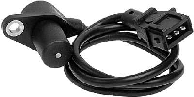

Any way, as far as the 60 minus 2 tone wheel - consider having your crank pulley machined with a 60-2 setup - we had it done on an Alfa 2000 engine pulley and it looks like it will work just fine - OR - Press the ring from a 24 valve crank pulley on to a 12 valve pulley and install the crank-angle sensor from it as well...
I am also working on a manufacturer who would make us brand new pulleys with the correct balance-factor from any motor already in the pulley as well as 60 minus two teeth on there - ready to go... Pulleys can even be made with serpentine grooves so that one could convert the entire setup Milano/75/GTV6 setup to a later serp-driven 164 A/C, alternator and P/S drive for example...

Help me source compatible crank-angle sensors please - AR 164 units run 200 USD...

should be bosch part nr 0 261 210 036....costs arrount 75€...

"...about..." How much for real!? They're 220 list (dollars) here in the US!
With discounts on discounts on discounts I can buy for about 160 USD here...

hmm...just got the price from bosch...143.70 CHF w/o VAT....i will look if i can have a discount...

there is an hella replacement part 6PU 009 146-201 for 70 CHF...
