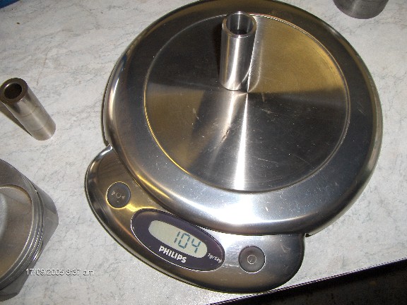

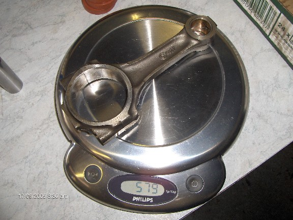

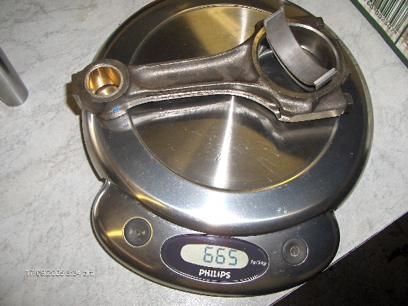

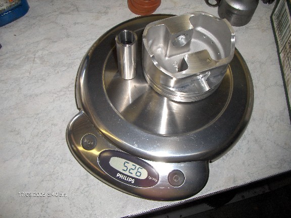

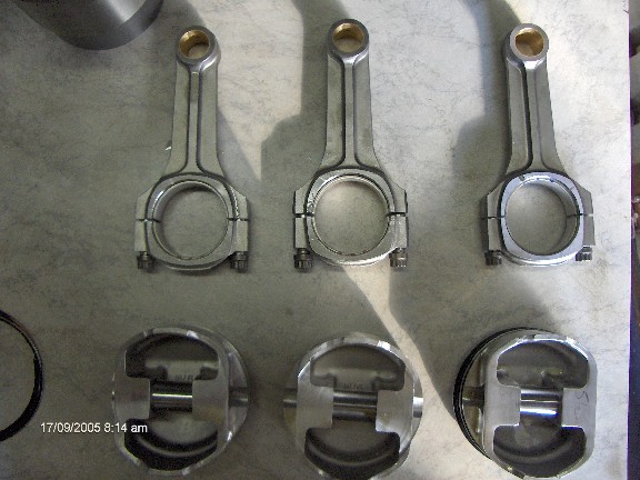

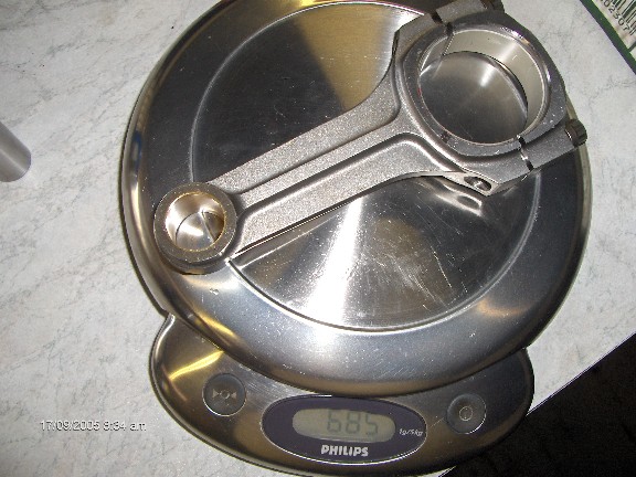

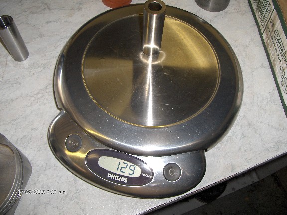

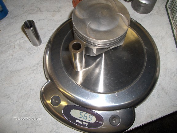

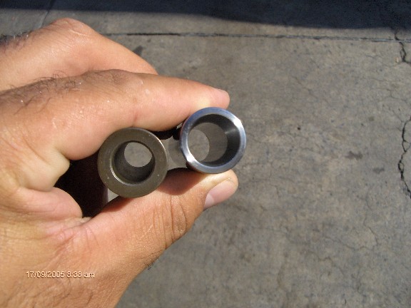

...and where I was going with this (since part of the topic seems to have included the weight), one of the things we were after was a reduction in the combined weight (or at least an equal to stock combined final weight) for a particular new piston/rod assembly (particularly in a big-bore, since the piston speeds go through the roof with some of the combinations and weight is therefore pretty important...)
A combination of good rods though (such as the ones that Jim/Greg suggested, or the ones that we use), with good pistons (even if the bore-size is increased from say 88mm - or 93mm in the 3.0 and 3.2 - to almost 100 in the 3.7) will get you there!
In the pics below I tried to keep it pretty fair and equal with bearings included and the wrist-pins separated (stock versus after-market) and then the pistons and wrist-pins weighed together! (You will find that the tapered forged steel c'molly wrist-pins that come with the pistons that we use, are pretty important to the whole combined weight equation!)

In the end we get a total combined stock weight of 1,234 grams for the 3.2 GTA 93mm combination and 1,211 grams for the chrome molly forged steel rod and wrist pin and forged aluminium alloy piston combination...! ALL of it stronger, 23 grams lighter overall, an increase of 450 to 500 ccs and compression to choose from in the finish of the tops!
