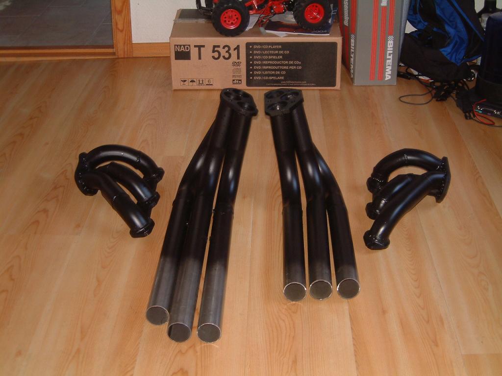

I am building my own headers with 1.75" prims. Will add a pic during this week.

Greg: I am waiting for my bent tubes now, if they dont show up today I will have to wait until monday. I will make my own as a"test model" and if everything works out fine and the price is ok, i may concider to make some sets.

Finally finished my new set of "big bore" headers. ID is 41mm. These were not just "bolt on". Had to make changes to the chassis to make them fit.
Trying to post a picture but its to big.... If someone want a pic let me know and I can send to a mail adress.
Jarle
Nice Job, Jarle, I really like the picture. I am glad to see someone finally steped up to the plate and made a pair of big bore headers.

Here they are. Collectors are made today.
