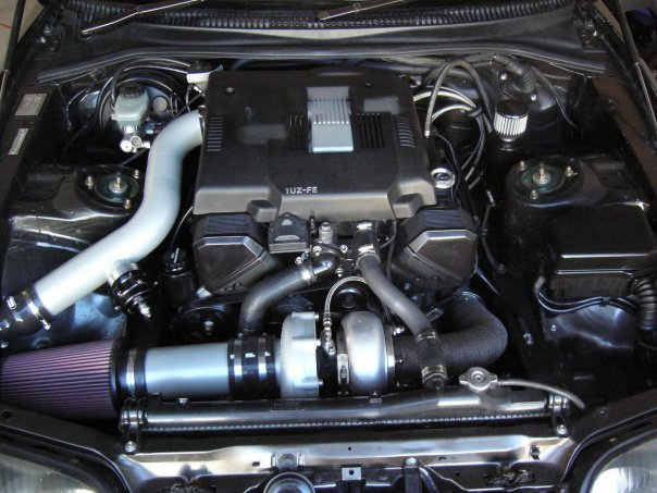

A slight variation of that design.
Garth, I wish you'd stop telling us about your turbo, I'm to easily tempted and my project is at snails pace with no effort put into any engine work (read: turbo (s) still a possibility :P)

GarthW wrote:What car is that from Duk..is it a toyota aristo or something like that..?
Close enough, it's a JZA80 Supra with the 1UZFE V8 fitted, but they are based on the same chassis as the Aristo (tho the Aristo never came with a V8 either).
