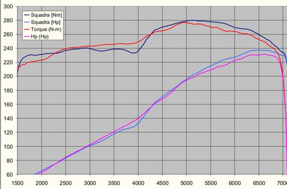

We dynoed a stock 164Q4 24 valve 3.0 some weeks ago. With and without Squadra chip. Not very surprisingly the chip didn't deliver even close what it was supposed to. Graph attached.

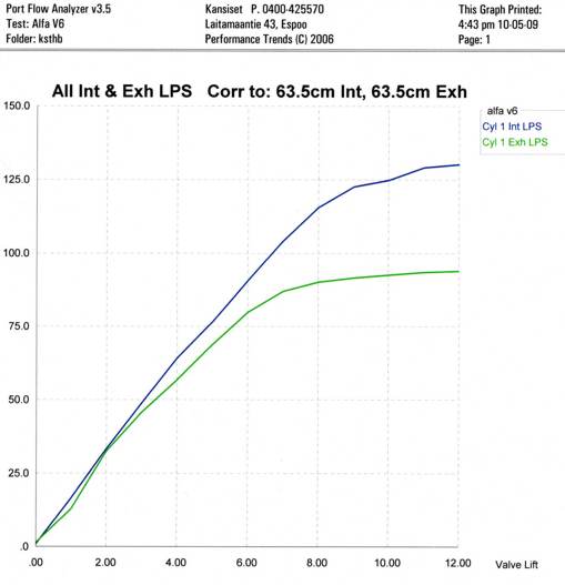

Now the heads for mine are ready and they flow like crazy. There is potential for almost anything.
Flow graph Q4.jpg (21.57 KiB) Viewed 6778 times
The stock intake manifold seems to do it's job well. Flows enough for my goal.

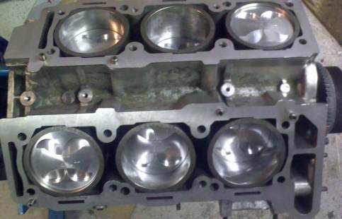

The pistons are in and ready. The heads are going on within days. Hope to have the engine mounted in some weeks. The hoist is occupied now so it will wait.

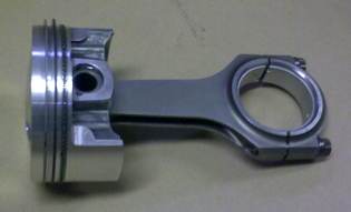

Pistons are 101 mm from Germany and the rods the "JK's" from UK.

Interesting, the dip is knocking issues I presume?

I think the dip in the Squadra chip is just bad programming. Mabe it tries to advance too much and knocks. Gasoline was 98 oct as it should. These are both driven within 15 min. The stock curve is probably due to the horribly short exhaust primaries and intake.

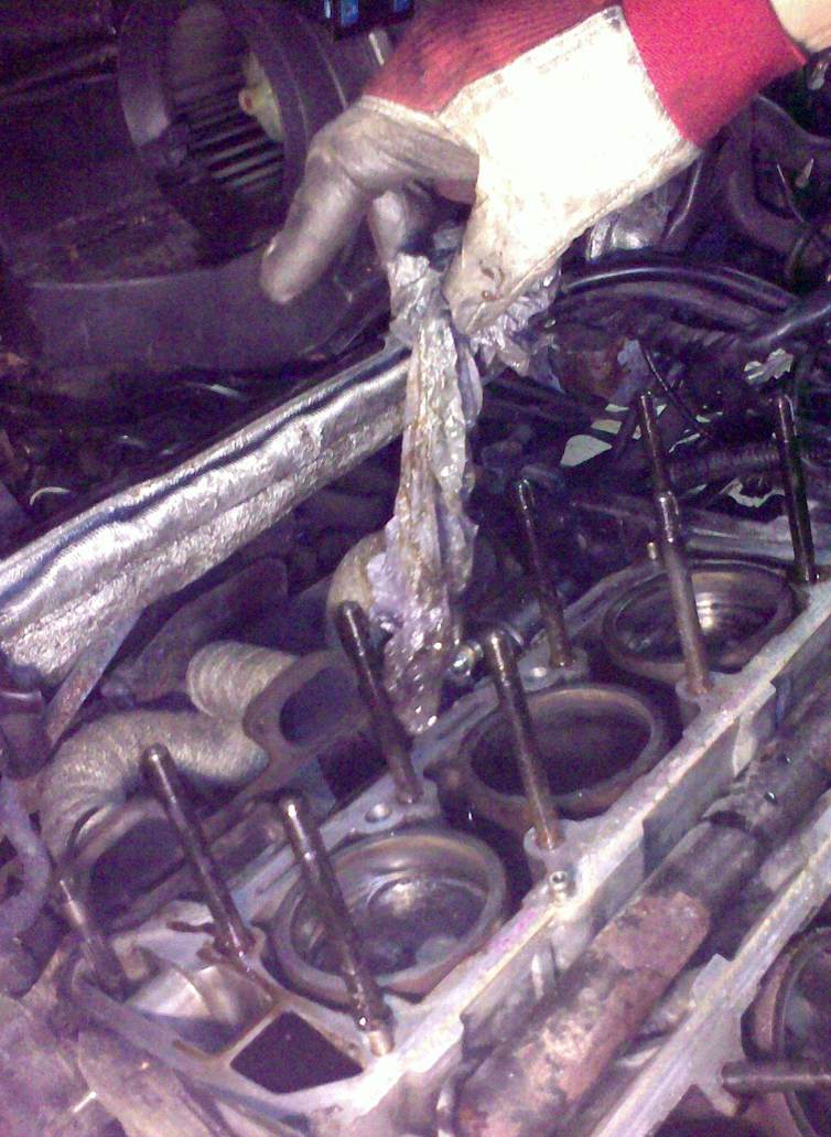

BTW, maybe something to learn from this:
2 of the 3 Q4's I've bought came with "spare parts" in the trunk. The first one cams and stuff. One of the last ones "only" 12 (six intake and 6 exhaust) S shaped valves.
Almost identical story.... sad one for the owners
1) Cam belt broke or jumped
2) Repaired but gone wrong
3) Lotsa loot used to repair the stuff and when it still loses the water in the oil the owners get fed up and sell the shit. (for less than the repair cost)
4) I buy and deal with the problems. One case likely sleeves came up durin repair. The other one was made by a "alfa mechanic as he said himself" and this guy didn't spare on mounting sand in the engine. Also found paper in the engine.

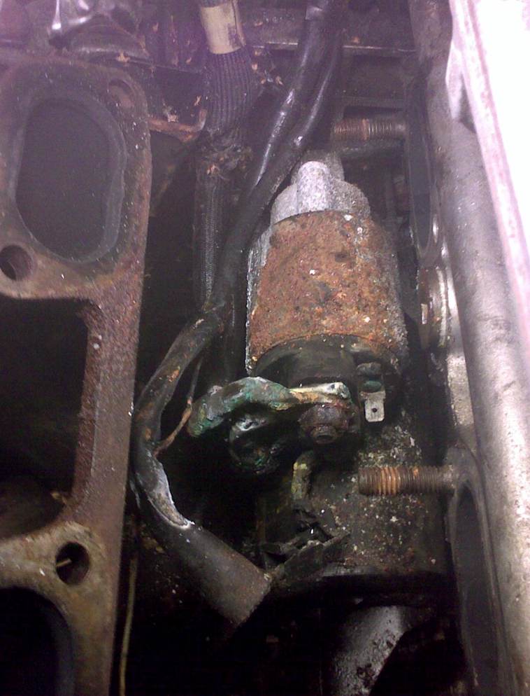

Heads were at half the torque they should. Starter cable wasn't fastened but ground against the chassis catching fire.

Piston and liners came from http://www.ps-schulze.de/
Pistons are stamped AW-Delta so they come from there. I asked them too but they didn't offer sleeves.
I wanted to buy from AH Motorsports but they were too busy to send me an invoice. Horrible attitude to customers. I won't ask them anything again.
We are considering creating a piston and sleeve package which wouldn't cost as horribly as these ones. It's just in planning though.
