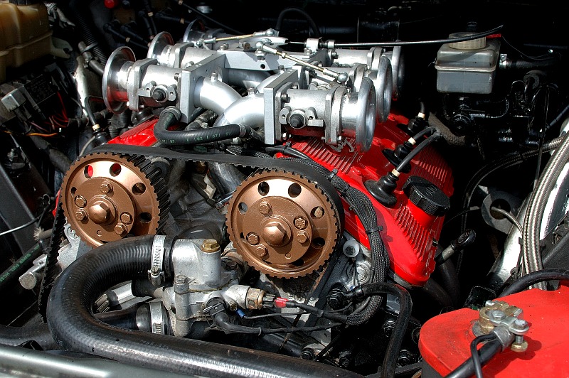

Re: 2.5 future mods - engine direction?
if you set urs up like below, runner lenght could be made long enough to suit your needs? without having to worry about bonnet clearance?
- engine4gg.jpg (192.95 KiB) Viewed 5506 times
I had thought of something like that. It depends on linkage and fuel rail placement.... but it adds to runner length- not a bad thing. I will need to wait until I've sorted my bonnet with the Zender moulding on it. That will determine space available.
