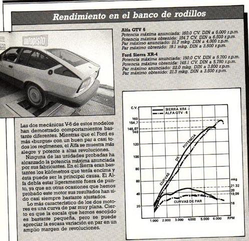

Here is a dyno run from a Spanish magazine, euro specs gtv6 (no cat), so here the cars can have 5 hp more than cat versions.
The text says that the Ford Sierra (2.8 v6) have high mileage, and maybe doesn´t give the factory hp for this reason.
The Gtv6 maybe need a check (ignition advance) because other ones gives near 160 about 6000 rpm.
The 3.0 engines are around 185 hp, and the QV version (whit cat) 180 !! (factory claims 192...), alfa 164 are up to 184 hp (almost the same engine as 75 QV).
