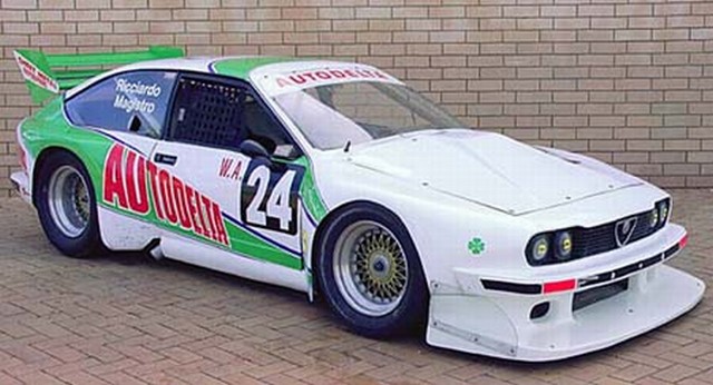

My race car! :D
Autodelta GTV6?
Autodelta GTV6?
